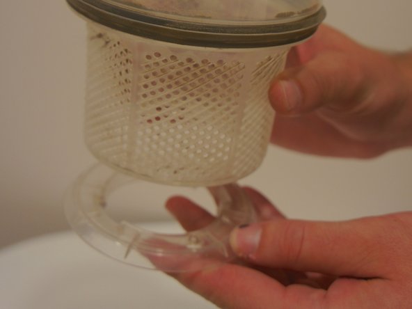

    • Press the grey dust cup release button and gently pull the dust cup towards you.
  2. Eureka AirSpeed Bagless Zuum Vacuum Wash Screen Replacement: crwdns2935265:02crwdnd2935265:01crwdnd2935265:02crwdne2935265:0 Eureka AirSpeed Bagless Zuum Vacuum Wash Screen Replacement: crwdns2935265:02crwdnd2935265:02crwdnd2935265:02crwdne2935265:0
    • Twist the large, black portion of the cyclone/dust cup to the right to unlock the black cyclone from the clear dust cup.
  3. Eureka AirSpeed Bagless Zuum Vacuum Wash Screen Replacement: crwdns2935265:03crwdnd2935265:01crwdnd2935265:02crwdne2935265:0 Eureka AirSpeed Bagless Zuum Vacuum Wash Screen Replacement: crwdns2935265:03crwdnd2935265:02crwdnd2935265:02crwdne2935265:0
    • Twist the clear collar to release the wash screen and small circular collar.
  4. Eureka AirSpeed Bagless Zuum Vacuum Wash Screen Replacement: crwdns2935265:04crwdnd2935265:01crwdnd2935265:01crwdne2935265:0
    • If screen is beyond washing clean or is cracked, connect new screen to cyclone and collar.

reattaching the collar to the wash screen is NOT EASY! I am not able to do it. What is the trick here??
ramsgusom - crwdns2934203:0crwdne2934203:0
Nvm. Just had to use my brain. there is a small groove in the plastic cylinder of the vacuum cleaner - the screen has to go below this - so that the collar can slide into the groove.
ramsgusom -
I wish there was a video on how to reattch the collar to the wash screen
