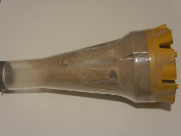

Eureka AirSpeed Bagless Zuum Vacuum Cyclone Replacement
  1. Eureka AirSpeed Bagless Zuum Vacuum Cyclone Replacement, Cyclone: crwdns2935265:01crwdnd2935265:01crwdnd2935265:02crwdne2935265:0 Eureka AirSpeed Bagless Zuum Vacuum Cyclone Replacement, Cyclone: crwdns2935265:01crwdnd2935265:02crwdnd2935265:02crwdne2935265:0
    • Press the grey dust cup release button and gently pull the dust cup towards you.
  2. Eureka AirSpeed Bagless Zuum Vacuum Cyclone Replacement: crwdns2935265:02crwdnd2935265:01crwdnd2935265:01crwdne2935265:0
    • Twist the large, black portion of the cyclone/dust cup to the right to unlock the black cover and cyclone from the clear dust cup.
  3. Eureka AirSpeed Bagless Zuum Vacuum Cyclone Replacement: crwdns2935265:03crwdnd2935265:01crwdnd2935265:01crwdne2935265:0
    • Twist the clear collar to release the wash screen and small circular collar exposing the cyclone attached to the black head.
  4. Eureka AirSpeed Bagless Zuum Vacuum Cyclone Replacement: crwdns2935265:04crwdnd2935265:01crwdnd2935265:01crwdne2935265:0
    • Lift the latch on the top of the black cyclone head to open. You can now see the foam filter inside the cyclone portion of the dust cup.
  5. Eureka AirSpeed Bagless Zuum Vacuum Cyclone Replacement: crwdns2935265:05crwdnd2935265:01crwdnd2935265:01crwdne2935265:0
    • Remove the white filter by lifting the gray foam filter handle, exposing the screws attaching cyclone to the black head.
  6. Eureka AirSpeed Bagless Zuum Vacuum Cyclone Replacement: crwdns2935265:06crwdnd2935265:01crwdnd2935265:01crwdne2935265:0
    • Using a T15 Security Torx Screwdriver, remove the 8 screws.
  7. Eureka AirSpeed Bagless Zuum Vacuum Cyclone Replacement: crwdns2935265:07crwdnd2935265:01crwdnd2935265:02crwdne2935265:0 Eureka AirSpeed Bagless Zuum Vacuum Cyclone Replacement: crwdns2935265:07crwdnd2935265:02crwdnd2935265:02crwdne2935265:0
    • Upon removal of the screws, the cyclone and black head cover will come apart.
