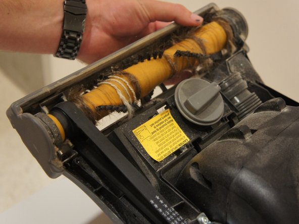

  4. Eureka AirSpeed Bagless Zuum Vacuum Belt Replacement: crwdns2935265:04crwdnd2935265:01crwdnd2935265:01crwdne2935265:0
    • Firmly press upwards from below the brush roll on the side opposite the belt.
  5. Eureka AirSpeed Bagless Zuum Vacuum Belt Replacement: crwdns2935265:05crwdnd2935265:01crwdnd2935265:01crwdne2935265:0
    • After one end is displaced, remove the other side by pressing firmly upwards from below the the brush roll.
  6. Eureka AirSpeed Bagless Zuum Vacuum Belt Replacement: crwdns2935265:06crwdnd2935265:01crwdnd2935265:01crwdne2935265:0
    • Once the brush roll is displaced from the base, detach the belt from the brush roll in order to clean the brush roll.

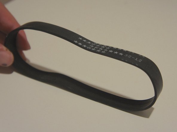

  7. Eureka AirSpeed Bagless Zuum Vacuum Belt Replacement, Belt: crwdns2935265:07crwdnd2935265:01crwdnd2935265:03crwdne2935265:0 Eureka AirSpeed Bagless Zuum Vacuum Belt Replacement, Belt: crwdns2935265:07crwdnd2935265:02crwdnd2935265:03crwdne2935265:0 Eureka AirSpeed Bagless Zuum Vacuum Belt Replacement, Belt: crwdns2935265:07crwdnd2935265:03crwdnd2935265:03crwdne2935265:0
    • Remove the belt from around the motor.
