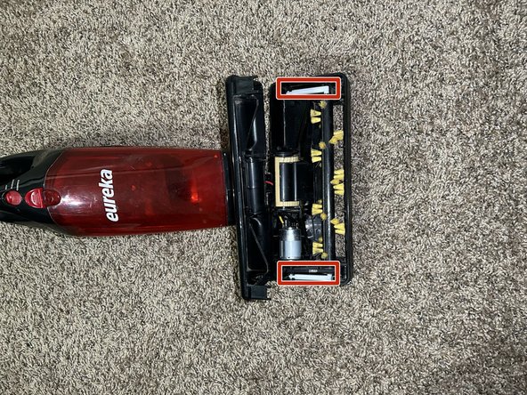

  4. Eureka 169 J 2-in-1 Quick-Up Brush Roll Replacement: crwdns2935265:04crwdnd2935265:01crwdnd2935265:01crwdne2935265:0
    • Pull the bottom and top cover of the brush roll compartment apart.
    • Internal components of the vacuum may fall out during this step, so keep track of where they are located for reassembly.
  5. Eureka 169 J 2-in-1 Quick-Up Brush Roll Replacement: crwdns2935265:05crwdnd2935265:01crwdnd2935265:03crwdne2935265:0 Eureka 169 J 2-in-1 Quick-Up Brush Roll Replacement: crwdns2935265:05crwdnd2935265:02crwdnd2935265:03crwdne2935265:0 Eureka 169 J 2-in-1 Quick-Up Brush Roll Replacement: crwdns2935265:05crwdnd2935265:03crwdnd2935265:03crwdne2935265:0
    • Lift the brush roll out of the vacuum.
    • The brush roll is connected to two white placeholders on both left and right sides. To remove these, pull them away from the brush roll.

  7. Eureka 169 J 2-in-1 Quick-Up Brush Roll Replacement: crwdns2935265:07crwdnd2935265:01crwdnd2935265:02crwdne2935265:0 Eureka 169 J 2-in-1 Quick-Up Brush Roll Replacement: crwdns2935265:07crwdnd2935265:02crwdnd2935265:02crwdne2935265:0
    • To replace the brush roll, attach the two white placeholders on both ends of the brush roll and set them into the corresponding slots.
    • The slots are located on the left and right ends of the bottom cover.
