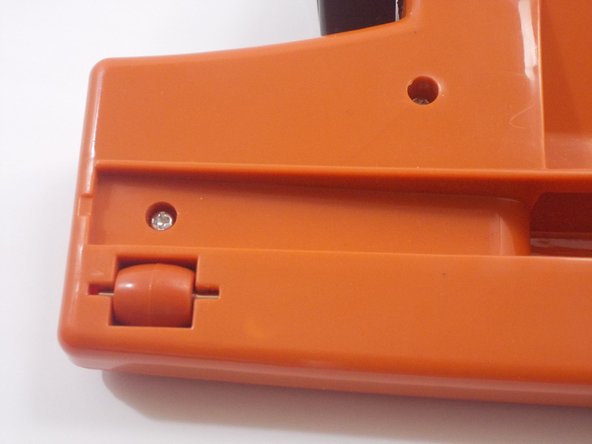

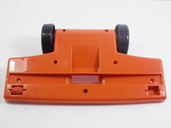

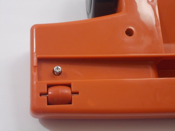

Eureka 1660SP Roller Replacement
  1. Eureka 1660SP Roller Replacement, Roller: crwdns2935265:01crwdnd2935265:01crwdnd2935265:02crwdne2935265:0 Eureka 1660SP Roller Replacement, Roller: crwdns2935265:01crwdnd2935265:02crwdnd2935265:02crwdne2935265:0
    • Press the black separator switch and lightly pull the bottom half away from the top.
  2. Eureka 1660SP Roller Replacement: crwdns2935265:02crwdnd2935265:01crwdnd2935265:02crwdne2935265:0 Eureka 1660SP Roller Replacement: crwdns2935265:02crwdnd2935265:02crwdnd2935265:02crwdne2935265:0
    • Remove the vacuum head from the lower half of the body.
  3. Eureka 1660SP Roller Replacement: crwdns2935265:03crwdnd2935265:01crwdnd2935265:03crwdne2935265:0 Eureka 1660SP Roller Replacement: crwdns2935265:03crwdnd2935265:02crwdnd2935265:03crwdne2935265:0 Eureka 1660SP Roller Replacement: crwdns2935265:03crwdnd2935265:03crwdnd2935265:03crwdne2935265:0
    • Turn the vacuum head wheels up and remove all seven 13.9mm screws from the bottom using a #2 Phillips head screwdriver.
    • Separate the top and bottom of the vacuum head. Set the top aside.
  4. Eureka 1660SP Roller Replacement: crwdns2935265:04crwdnd2935265:01crwdnd2935265:02crwdne2935265:0 Eureka 1660SP Roller Replacement: crwdns2935265:04crwdnd2935265:02crwdnd2935265:02crwdne2935265:0
    • Turn the vacuum head's bottom over so that the inside of the head is facing up.
    • Using a Phillips #00 screwdriver, press down on metal bar of the roller on one side until it releases from the housing.
    • Turn the vacuum head's bottom over and pull at the roller and bar until they are completely out of the housing.
  5. Eureka 1660SP Roller Replacement: crwdns2935265:05crwdnd2935265:01crwdnd2935265:01crwdne2935265:0
    • Press the new bar and roller into place.
    • Replace the screws.
