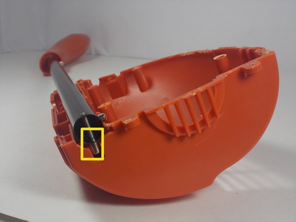

  4. Eureka 1660SP Extendable Pole Realignment, Realignment of the extendable pole: crwdns2935265:04crwdnd2935265:01crwdnd2935265:01crwdne2935265:0
    • Once the housing is open, locate the solid chrome plated piece at the front end of the extendable pole.
  5. Eureka 1660SP Extendable Pole Realignment: crwdns2935265:05crwdnd2935265:01crwdnd2935265:02crwdne2935265:0 Eureka 1660SP Extendable Pole Realignment: crwdns2935265:05crwdnd2935265:02crwdnd2935265:02crwdne2935265:0
    • On the side of the motor housing which does not hold the engine, find the center track which runs along the inside of the housing.
    • Re-insert the chrome plated piece into the center track.
