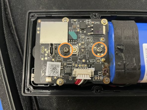

    • Water manage to get into my unit and fried this chip. Suggest you use a rain cover if this doorbell is expose to weather outdoors. There are a lot of 3D printed rain covers for this doorbell.
  5. Eufy Video Doorbell 2k (Battery-Powered) Teardown: crwdns2935265:05crwdnd2935265:01crwdnd2935265:02crwdne2935265:0 Eufy Video Doorbell 2k (Battery-Powered) Teardown: crwdns2935265:05crwdnd2935265:02crwdnd2935265:02crwdne2935265:0
    • Remove 4 screws with a Phillips 000.
    • Remove 2 screws with a Phillips 0.

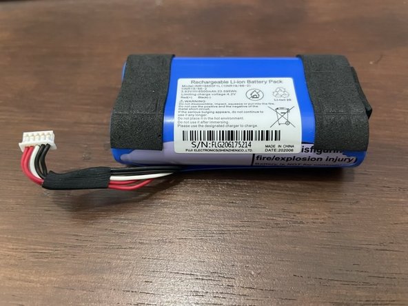

  7. Eufy Video Doorbell 2k (Battery-Powered) Teardown: crwdns2935265:07crwdnd2935265:01crwdnd2935265:02crwdne2935265:0 Eufy Video Doorbell 2k (Battery-Powered) Teardown: crwdns2935265:07crwdnd2935265:02crwdnd2935265:02crwdne2935265:0
    • Battery details and specification.
    • You can use a multimeter to check the voltage of the battery. Mine was still good at 3.9V. Unfortunately the chip got fried.

This is great. Any suggestions for sourcing a new battery pack?
Tezza - crwdns2934203:0crwdne2934203:0
My battery may be shot. Same as in pics. Where can I get a replacement?
Joe Guy - crwdns2934203:0crwdne2934203:0
I tried changing the battery in mine. Got it sourced individual cell and attached to the existing points (by removing old cells). It got really hot. Seems my chip got fried as well. Not sure how to check if there is anything else faulty than BAttery Chip?
