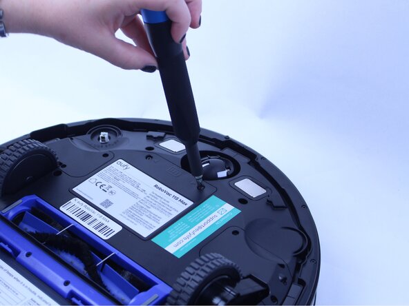

    • Turn the vacuum off.
    • Flip the Robovac over so it is upside down.
  2. Eufy Robovac 11s Max Battery Replacement: crwdns2935265:02crwdnd2935265:01crwdnd2935265:02crwdne2935265:0 Eufy Robovac 11s Max Battery Replacement: crwdns2935265:02crwdnd2935265:02crwdnd2935265:02crwdne2935265:0
    • Use a Phillips head screwdriver to remove the screws holding the battery plate down.
    • Remove the battery plate.
  3. Eufy Robovac 11s Max Battery Replacement: crwdns2935265:03crwdnd2935265:01crwdnd2935265:01crwdne2935265:0
    • Detach the battery connector.
    • Remove the battery.
