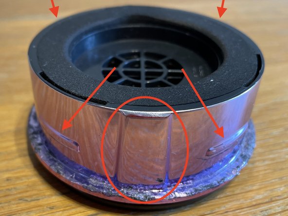

  3. Eufy HomeVac H11 Battery Replacement, Remove the main cover: crwdns2935265:03crwdnd2935265:01crwdnd2935265:02crwdne2935265:0 Eufy HomeVac H11 Battery Replacement, Remove the main cover: crwdns2935265:03crwdnd2935265:02crwdnd2935265:02crwdne2935265:0
    • Once you've gone all around the body and popped open all four teeth, it should be trivial to pull out the cover
    • Notice in the 1st and 2nd photos the location of the teeth, you'll need to match them with their corresponding grooves when assembling
    • Notice in the 1st photo, in the red square at the centre, the engine's blades are exposed. Do not insert your fingers or any other items in there.
    • Also notice in the 2nd photo circled is the guiding indentation. This indentation needs to match with its corresponding groove at the front of the device, right behind the Eufy logo, when assembling

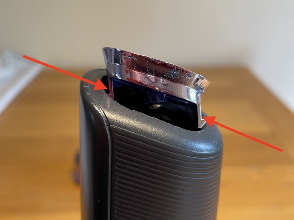

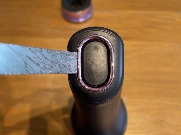

  4. Eufy HomeVac H11 Battery Replacement, Pry open the handle vent cover: crwdns2935265:04crwdnd2935265:01crwdnd2935265:03crwdne2935265:0 Eufy HomeVac H11 Battery Replacement, Pry open the handle vent cover: crwdns2935265:04crwdnd2935265:02crwdnd2935265:03crwdne2935265:0 Eufy HomeVac H11 Battery Replacement, Pry open the handle vent cover: crwdns2935265:04crwdnd2935265:03crwdnd2935265:03crwdne2935265:0
    • The end of the handle contains a vent, which I think is there so that part of the air flow goes around the batteries, cooling them (more on that later)
    • The vent cover is held in place by two teeth, shown in the photos by the arrows
    • Though the teeth are at the narrow/rounded edges of the vent cover, I recommend prying it open by working the straight edges because then you can use the pry tool with maximum advantage and avoid damaging the rounded edge
    • In contrast to the main cover, the vent cover doesn't require much force to open

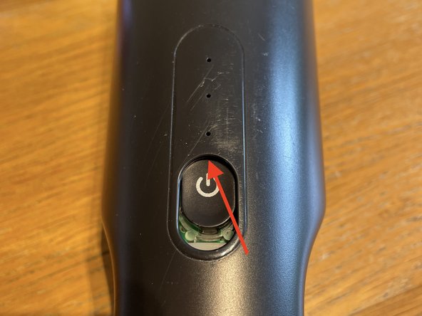

  5. Eufy HomeVac H11 Battery Replacement, Push out the vacuum internals: crwdns2935265:05crwdnd2935265:01crwdnd2935265:02crwdne2935265:0 Eufy HomeVac H11 Battery Replacement, Push out the vacuum internals: crwdns2935265:05crwdnd2935265:02crwdnd2935265:02crwdne2935265:0
    • Once the vent cover has been removed, it is possible to push out the vacuum contents by pressing here, shown by the arrow in the 1st photo
    • The on/off button will prevent the contents from sliding out, so it needs to be pushed in. Do that by pressing it's front edge (shown by the arrow on 2nd photo), while also continuing to push the internals through the handle

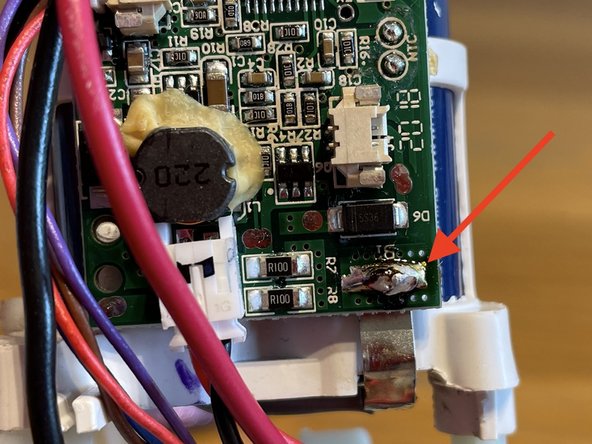

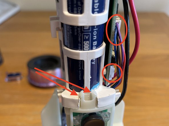

  6. Eufy HomeVac H11 Battery Replacement, Removing the battery housing: crwdns2935265:06crwdnd2935265:01crwdnd2935265:02crwdne2935265:0 Eufy HomeVac H11 Battery Replacement, Removing the battery housing: crwdns2935265:06crwdnd2935265:02crwdnd2935265:02crwdne2935265:0
    • The batteries housing is held together by the two teeth on the assembly front; the one tooth at the back, that keeps the two halves together; the one screw that holds the main circuit board to the top half of the batteries housing; two pin connectors; and, sadly, the nickel strips that are welded to the battery terminals;
    • In this step:
    • unscrew the circuit board screw (arrow in the 1st photo)
    • bend the two teeth at the front of the assembly (indicated by arrows in the 2nd photo)
    • unplug the pin connectors 1 and two (circled in the 1st and 2nd photos)
    • undo the two halves of the battery assembly on the side opposite the circuit board
    • and, as carefully as possible, break off the strips welded to the battery terminals. NB: do not short the battery + and - terminals with your tool while working on it
    • for access to the top terminals, unscrew the translucent plastic cap that covers it.
    • You'll see a red wire glued to the batteries. This is (presumably) the overheating sensor. You'll need it later, so be careful not to damage it. Carefully scrape the glue/cement from the battery.
    • When the battery housing is disassembled and the batteries are free of the welding, they can be removed and recycled.

  8. Eufy HomeVac H11 Battery Replacement, Connect the new batteries to the circuit board: crwdns2935265:09crwdnd2935265:01crwdnd2935265:02crwdne2935265:0 Eufy HomeVac H11 Battery Replacement, Connect the new batteries to the circuit board: crwdns2935265:09crwdnd2935265:02crwdnd2935265:02crwdne2935265:0
    • Depending on your materials and tools, solder or weld the new batteries to the battery terminals
    • Depending on how badly damaged have the old metal strips become when ripping off the welding from the batteries, you might be able to reuse them and just solder/weld them to the new batteries. However, in most cases you'll have to first unsolder the old strips from the circuit board.
    • Soldering to battery terminals is perhaps the most difficult part of this entire procedure. Here's a pretty good Youtube video that shows how to do it.
    • When connecting the batteries, remember that the wiring needs to be passed through the two halves of the battery assembly. Once the batteries are soldered to the circuit board, you won't be able to re-assemble the battery housing around it any more.
    • In the photos are shown the three circuit board locations where the batteries need to be connected to
    • B+ and B-
    • The batteries need to be connected between themselves, making a series of 2 batteries
    • The mid-point between the batteries needs to be connected to the terminal at the bottom end of the circuit board (2nd photo). NB: it is necessary to connect this point too, otherwise the vacuum will refuse to charge the batteries
    • NB: don't forget to stick red wire (thermal sensor?) to the batteries. Ideally to BOTH the batteries, just like it used to be. This is necessary for the safe operation of your device.
