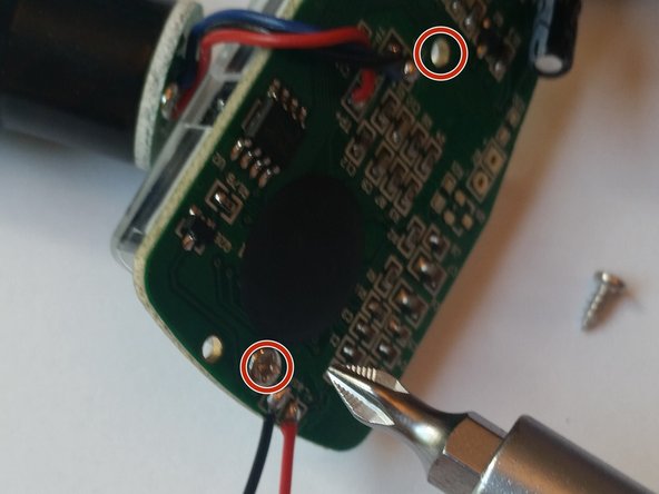

  11. Etekcity Lasergrip 1080 Screen Replacement: crwdns2935265:011crwdnd2935265:01crwdnd2935265:02crwdne2935265:0 Etekcity Lasergrip 1080 Screen Replacement: crwdns2935265:011crwdnd2935265:02crwdnd2935265:02crwdne2935265:0
    • Unscrew the two 3.4 mm screws on the motherboard.
  12. Etekcity Lasergrip 1080 Screen Replacement: crwdns2935265:012crwdnd2935265:01crwdnd2935265:01crwdne2935265:0
    • Take off the cover and separate the parts.
    • All of these parts are fragile and mishandling them may cause damage.
