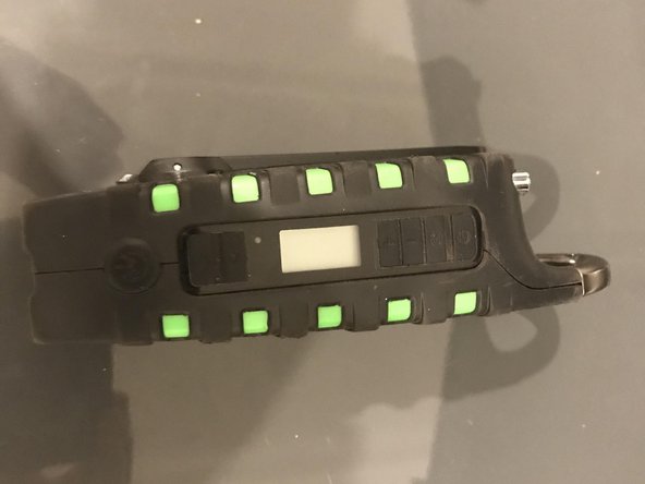

  1. Etón Scorpion Teardown, Etón Scorpion Teardown: crwdns2935265:01crwdnd2935265:01crwdnd2935265:03crwdne2935265:0 Etón Scorpion Teardown, Etón Scorpion Teardown: crwdns2935265:01crwdnd2935265:02crwdnd2935265:03crwdne2935265:0 Etón Scorpion Teardown, Etón Scorpion Teardown: crwdns2935265:01crwdnd2935265:03crwdnd2935265:03crwdne2935265:0

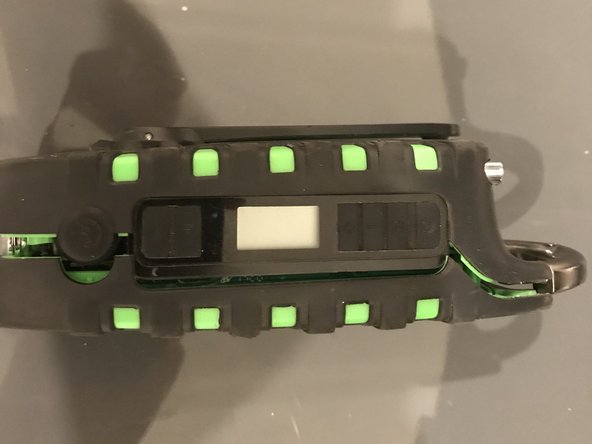

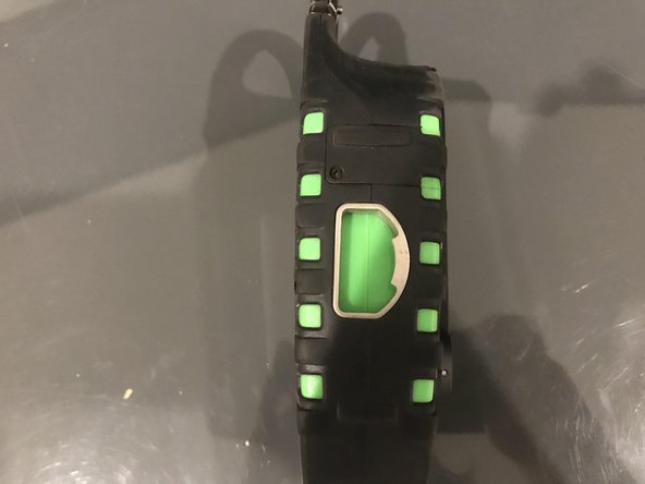

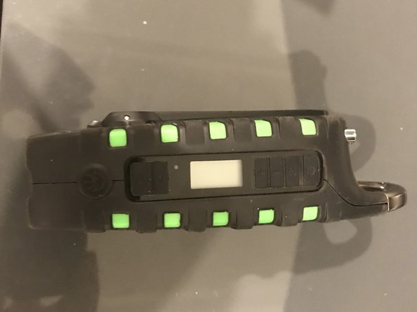

    • The front of the device has a solar panel and a speaker grill.
    • The only obvious screws are the battery cover and the back.

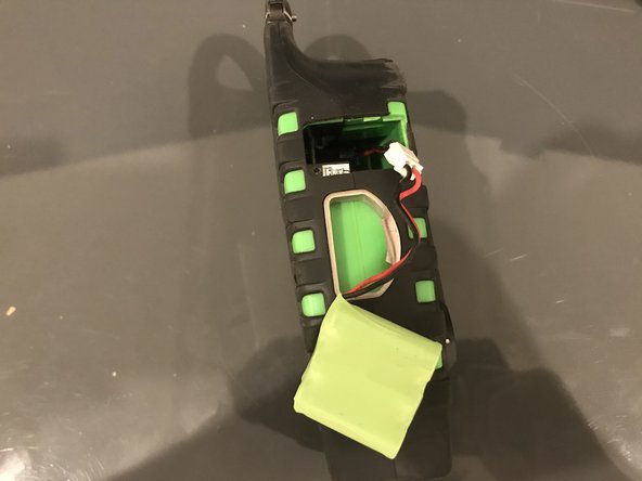

  2. Etón Scorpion Teardown: crwdns2935265:02crwdnd2935265:01crwdnd2935265:03crwdne2935265:0 Etón Scorpion Teardown: crwdns2935265:02crwdnd2935265:02crwdnd2935265:03crwdne2935265:0 Etón Scorpion Teardown: crwdns2935265:02crwdnd2935265:03crwdnd2935265:03crwdne2935265:0
    • Removing the battery cover reveals an easily user-replaceable battery (hooray!)
    • It takes a single Phillips head screwdriver

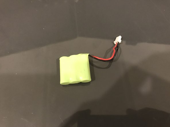

  3. Etón Scorpion Teardown: crwdns2935265:03crwdnd2935265:01crwdnd2935265:03crwdne2935265:0 Etón Scorpion Teardown: crwdns2935265:03crwdnd2935265:02crwdnd2935265:03crwdne2935265:0 Etón Scorpion Teardown: crwdns2935265:03crwdnd2935265:03crwdnd2935265:03crwdne2935265:0

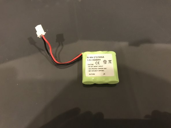

    • Removing the battery shows a standard form factor.
    • If you're looking for a replacement, I've got you.

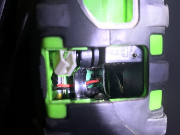

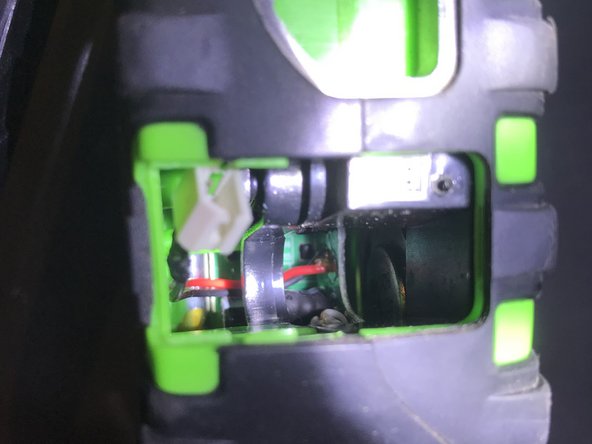

  4. Etón Scorpion Teardown: crwdns2935265:04crwdnd2935265:01crwdnd2935265:01crwdne2935265:0
    • Peeking inside with a flashlight and camera, we can see some internals.
    • Let's get inside!

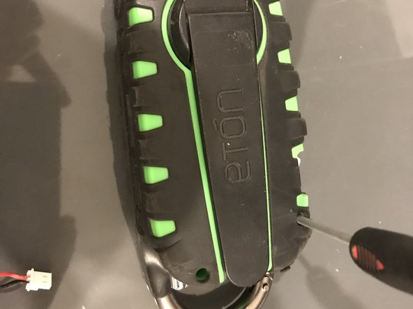

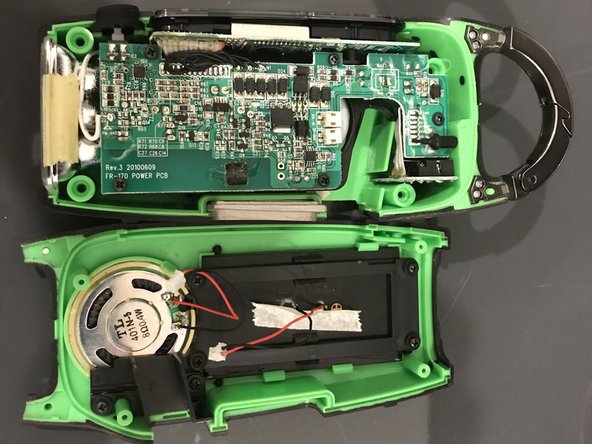

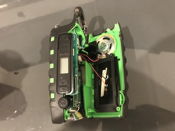

  5. Etón Scorpion Teardown: crwdns2935265:05crwdnd2935265:01crwdnd2935265:03crwdne2935265:0 Etón Scorpion Teardown: crwdns2935265:05crwdnd2935265:02crwdnd2935265:03crwdne2935265:0 Etón Scorpion Teardown: crwdns2935265:05crwdnd2935265:03crwdnd2935265:03crwdne2935265:0
    • Removing the 4 screws and pulling apart the 2 halves worked
    • Let's look inside!

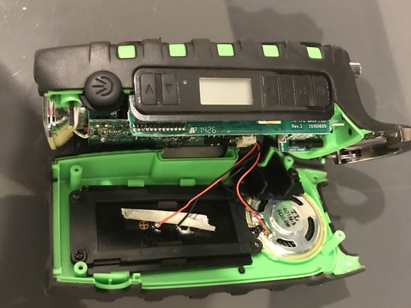

  6. Etón Scorpion Teardown: crwdns2935265:06crwdnd2935265:01crwdnd2935265:02crwdne2935265:0 Etón Scorpion Teardown: crwdns2935265:06crwdnd2935265:02crwdnd2935265:02crwdne2935265:0
    • immediately, we can see the speaker and solar panel.
    • I spot user-removable plugs. Horray!

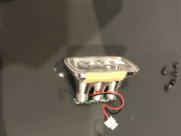

  9. Etón Scorpion Teardown: crwdns2935265:09crwdnd2935265:01crwdnd2935265:02crwdne2935265:0 Etón Scorpion Teardown: crwdns2935265:09crwdnd2935265:02crwdnd2935265:02crwdne2935265:0
    • The flashlight module is also removable, with a single jack holding the cable in place.
    • Once again, a win for repairability.

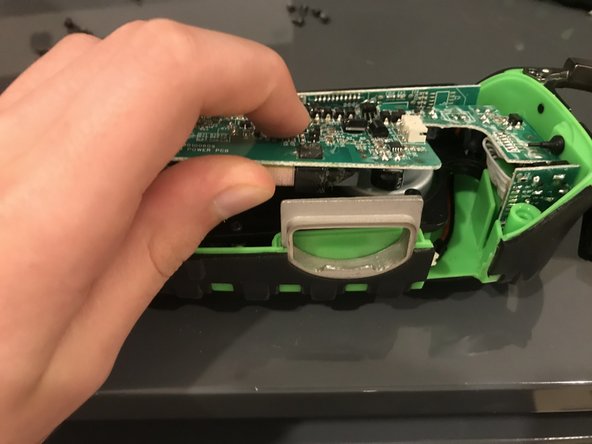

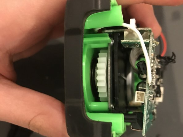

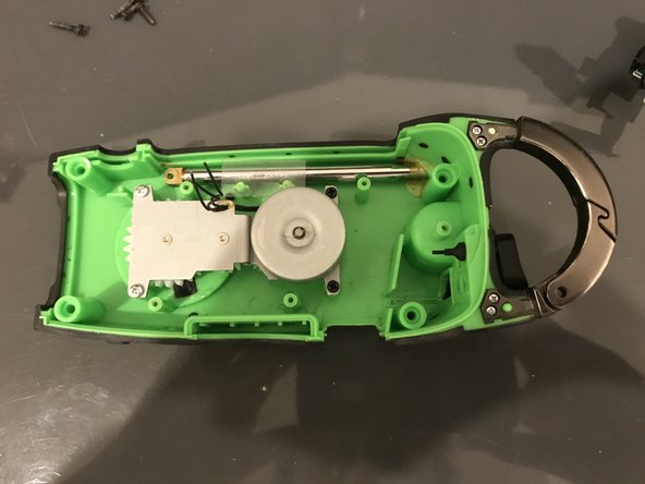

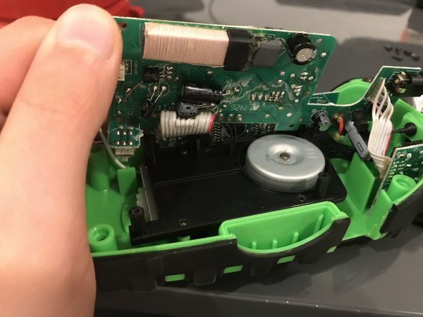

  10. Etón Scorpion Teardown: crwdns2935265:010crwdnd2935265:01crwdnd2935265:03crwdne2935265:0 Etón Scorpion Teardown: crwdns2935265:010crwdnd2935265:02crwdnd2935265:03crwdne2935265:0 Etón Scorpion Teardown: crwdns2935265:010crwdnd2935265:03crwdnd2935265:03crwdne2935265:0

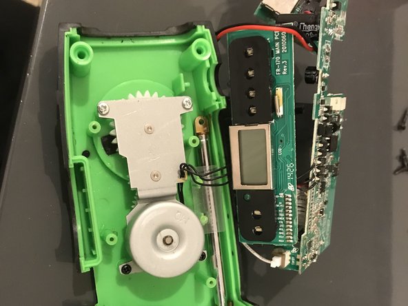

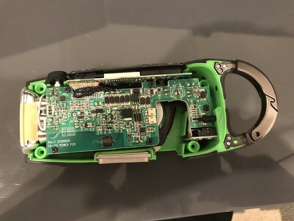

    • Pulling the power board away harder allows it to bend
    • here, we can see the underside, and how it REALLY works.
    • We can also see the hand crank generator on the bottom
    • to the right, is the USB and audio board. There is a ribbon cable connecting it, and it isn't user removable. :(
    • The power board and the main board are also user-inseparable :(
  11. Etón Scorpion Teardown, Conclusion: crwdns2935265:011crwdnd2935265:01crwdnd2935265:03crwdne2935265:0 Etón Scorpion Teardown, Conclusion: crwdns2935265:011crwdnd2935265:02crwdnd2935265:03crwdne2935265:0 Etón Scorpion Teardown, Conclusion: crwdns2935265:011crwdnd2935265:03crwdnd2935265:03crwdne2935265:0
    • To wrap it up, we saw examples of both good and bad repairability, as all the circuit board are inseparable, but the battery and other components that may break more easily are connected by a standard port.
    • All the screws, no matter how big or small, were standard Phillips Head, and not some weird GameBit screw. (Looking at you, Nintendo!)
    • It's significantly better than most devices out there, but not perfect. It's great for most consumers, unless you want to replace a specific circuit board.
