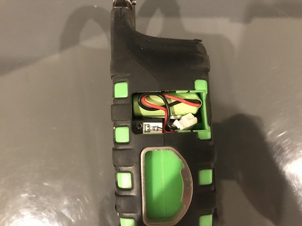

    • Your device should look like this.

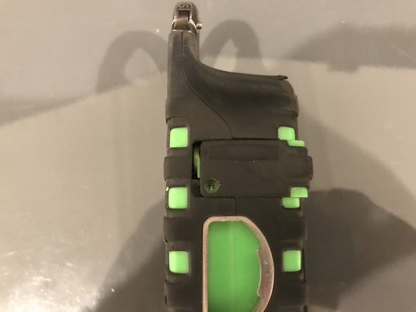

    • Turn the unit on its side and look for this panel.
  3. Etón Scorpion Battery Replacement: crwdns2935265:03crwdnd2935265:01crwdnd2935265:03crwdne2935265:0 Etón Scorpion Battery Replacement: crwdns2935265:03crwdnd2935265:02crwdnd2935265:03crwdne2935265:0 Etón Scorpion Battery Replacement: crwdns2935265:03crwdnd2935265:03crwdnd2935265:03crwdne2935265:0
    • Unscrew this screw with a Phillips head #0 screwdriver.
    • Remove the panel.

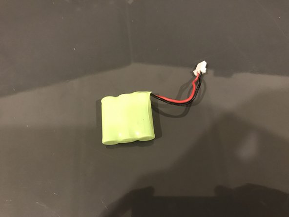

  4. Etón Scorpion Battery Replacement: crwdns2935265:04crwdnd2935265:01crwdnd2935265:03crwdne2935265:0 Etón Scorpion Battery Replacement: crwdns2935265:04crwdnd2935265:02crwdnd2935265:03crwdne2935265:0 Etón Scorpion Battery Replacement: crwdns2935265:04crwdnd2935265:03crwdnd2935265:03crwdne2935265:0
    • Pull out the battery and disconnect the connector.
To reassemble your device, follow these instructions in reverse order, and remember to connect the connector when putting in a new battery.

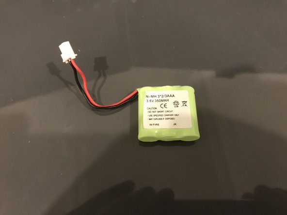

What specific battery did you purchase to replace the original battery pack? My battery needs to be 1.25” by 1.25” to fit into the compartment. Many of the batteries I have found on Amazon that claim to be replacement are much larger an won’t fit into the compartment.
Mark Chapin - crwdns2934203:0crwdne2934203:0
https://www.amazon.com/South-33053-Cordl...
This battery seems to be a good fit. It says in the question and answer section that it’s 1.2"" x 1.15"x 0.42".
9021007 -
Need to switch the wire positions. What's the best way?
