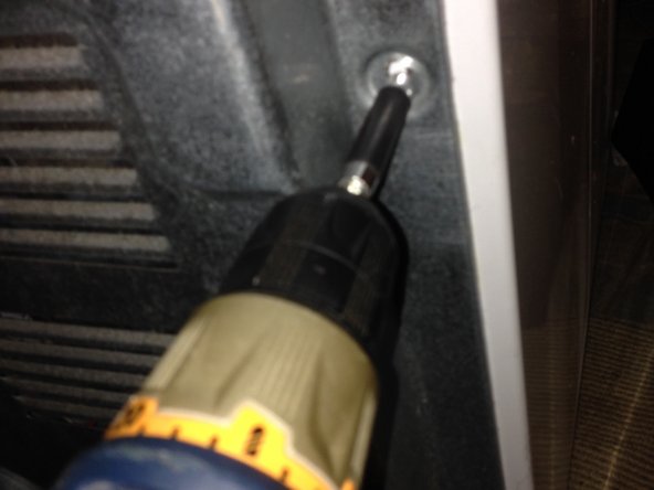

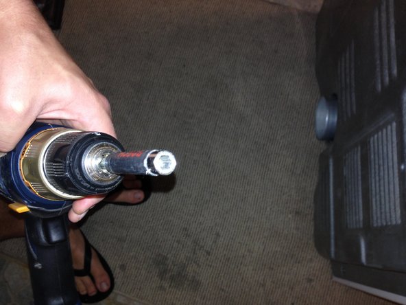

    • Pull the dryer back from the wall. Most Whirlpool made dryers have 9 (1/4") screws holding the back cover on. Don't forget to remove the cover plate for the cord. Save the screws in a safe place. I used my drills bit holder it's exactly 1/4" and worked perfectly.

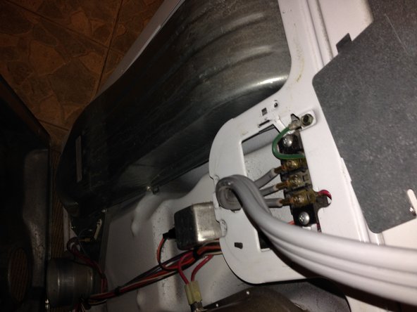

    • After removing all screws gently remove the rear cover and cord cover, place them against a wall. Be careful the edges of these can be sharp!

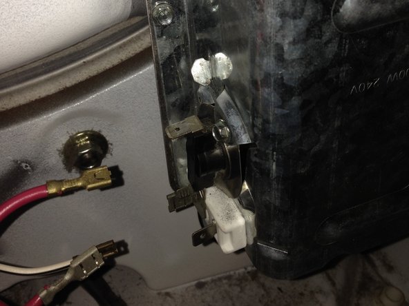

    • The dryer element is located in the bottom right corner of the case. Make note of the connection locations, I recommend taking a picture with your phone.
    • Remove the connectors to the element.
    • There are two more screws holding the element housing to the dryer, remove these and the element will come free by sliding down or pulling back.

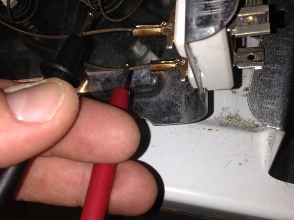

    • Set your multimeter to 20K Ohms.
    • Connect the leads of the multimeter to your element, if your element is functional you will receive a 0.00 reading, if it is faulty the resistance will vary or your multimeter will show 1. You can also visually inspect the element coil. Usually if the element has failed there will be a break somewhere in it.

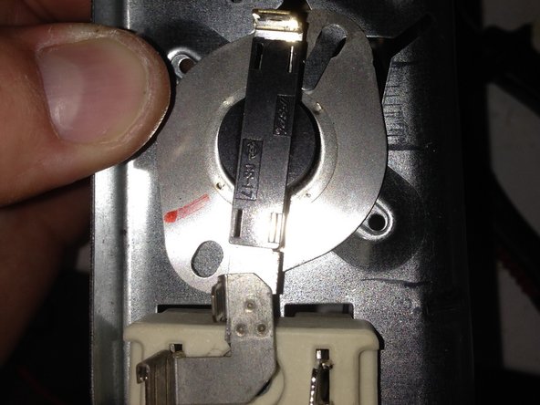

  7. Estate Mo No TEDS840PQ0 Dryer Heating Element Replacement: crwdns2935265:07crwdnd2935265:01crwdnd2935265:03crwdne2935265:0 Estate Mo No TEDS840PQ0 Dryer Heating Element Replacement: crwdns2935265:07crwdnd2935265:02crwdnd2935265:03crwdne2935265:0 Estate Mo No TEDS840PQ0 Dryer Heating Element Replacement: crwdns2935265:07crwdnd2935265:03crwdnd2935265:03crwdne2935265:0

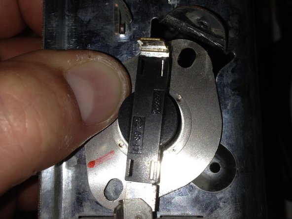

    • If you've verified the old element has failed, set them up sideways next to each other as shown. You will see your new element is missing a piece. Most new elements do NOT come with the high limit thermostat, this will need to be swapped over.
    • With your 6mm socket remove the bolt holding the high limit thermostat and *gently* pry back the top tab. Again *gently* pull the "L" shaped connector off the element terminal.
    • Your new element may or may not come with a screw hole for the thermostat. If not pry the tab back and slide it into the hole in the element where the old screw hole was and slide the "L" connector back onto the new terminal.
