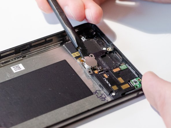

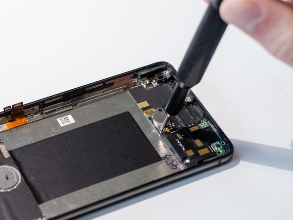

  29. Essential Phone Vibrator Replacement, Vibrator: crwdns2935265:029crwdnd2935265:01crwdnd2935265:02crwdne2935265:0 Essential Phone Vibrator Replacement, Vibrator: crwdns2935265:029crwdnd2935265:02crwdnd2935265:02crwdne2935265:0
    • Remove the two 1.25mm screws that hold on the vibrator cap using a Phillips #000 screwdriver.
  30. Essential Phone Vibrator Replacement: crwdns2935265:030crwdnd2935265:01crwdnd2935265:02crwdne2935265:0 Essential Phone Vibrator Replacement: crwdns2935265:030crwdnd2935265:02crwdnd2935265:02crwdne2935265:0
    • Using the flat edge of a spudger, lift off the vibrator cap from the device.

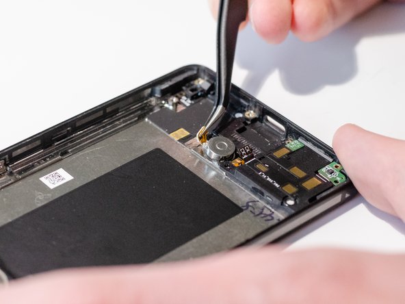

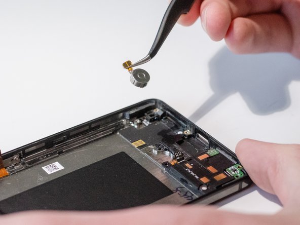

  31. Essential Phone Vibrator Replacement: crwdns2935265:031crwdnd2935265:01crwdnd2935265:03crwdne2935265:0 Essential Phone Vibrator Replacement: crwdns2935265:031crwdnd2935265:02crwdnd2935265:03crwdne2935265:0 Essential Phone Vibrator Replacement: crwdns2935265:031crwdnd2935265:03crwdnd2935265:03crwdne2935265:0
    • Use tweezers to get underneath the yellow wire attached to the vibrator.
    • Pull in the direction of the yellow wire to detach the vibrator from the glue sticking it to the phone.
    • Pull the vibrator out of the phone.
    • The glue is quite sticky and you may need to use some force to get the vibrator to detach it.
