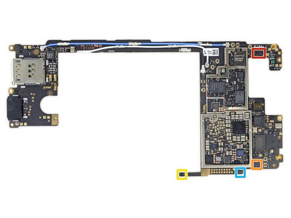

    • And for the backside:
    • Qorvo QM78012 RF fusion LB module
    • Skyworks Solutions 77360-2 power amplifier module
    • Avago AFEM-9046 and AFEM-9036 IC's
    • Qualcomm PM8998 (similar to PM8920)
    • NXP Semiconductors TFA9891 audio amplifier
    • Qualcomm SMB1381 power management IC
    • ON Semiconductor DC-DC converter (likely)
  10. Essential Phone Teardown: crwdns2935265:010crwdnd2935265:01crwdnd2935265:02crwdne2935265:0 Essential Phone Teardown: crwdns2935265:010crwdnd2935265:02crwdnd2935265:02crwdne2935265:0
    • And the rest of the chips:
    • Qualcomm PM8005 power management IC
    • SiBeam SB6212CZU Snap wireless connector IC
    • Fresco Logic FL1100-1A0-LX USB 3.0 host controller
    • Qualcomm QET4100 envelope tracker
    • Texas Instruments TPS61235P 8 A synchronous boost converters
    • NXP Semiconductor Q2101 NFC controller (likely)
    • ON Semiconductor FSUSB43L10X 480 Mbps, USB 2.0 DPDT switch
  11. Essential Phone Teardown: crwdns2935265:011crwdnd2935265:01crwdnd2935265:02crwdne2935265:0 Essential Phone Teardown: crwdns2935265:011crwdnd2935265:02crwdnd2935265:02crwdne2935265:0

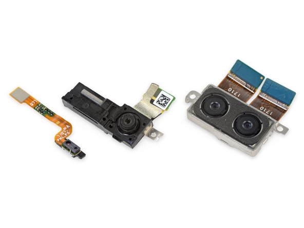

    • With the motherboard on ice, we're finally able to tweeze out the dual camera module.
    • Either Essential accidentally put these camera pop connectors on backwards, or someone had too much fun figuring how to origami them into place.
    • Nearby, the selfie cam lies on a strip of glue and takes a little more work to extract, bringing the front-facing sensor cable along for the ride.
    • Surprise! The front-facing camera and earpiece speaker come as a single part. That tiny port lines up directly with the über-slim grille at the top of the phone!
    • The small flex cable terminates with possibly an AMS TMD3700 color sensor.

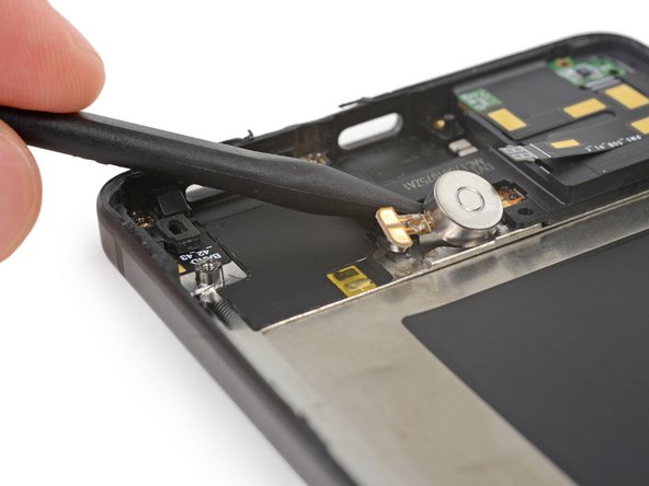

    • De-capping (literally, it looks like a cap) the vibrator, we're surprised there's no rubber dampener between these pieces.
    • The vibrator appears to be a standard pancake style cell motor, albeit a little taller than the usual short-stack.

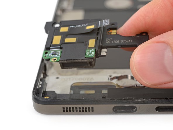

    • Among the final components out: the sprawling loudspeaker and accompanying contact cable.
    • With its odd shape, the speaker kinda looks like it was designed to fill all unclaimed real estate in the phone body.

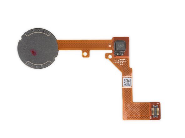

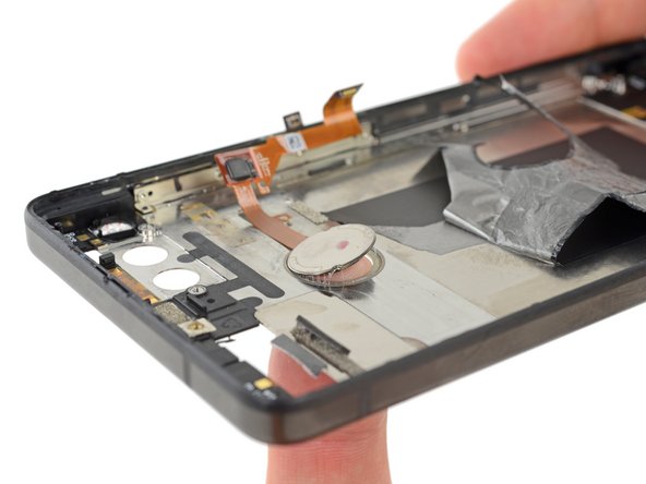

    • Not much remains besides the fingerprint sensor, glued comfortably in place on the back—a location that comes with some drawbacks, but is quickly becoming the de facto smartphone standard. Well, sort of.
    • The fingerprint sensor is likely a FPC1020, while the fingerprint controller may be a FPC2050.
