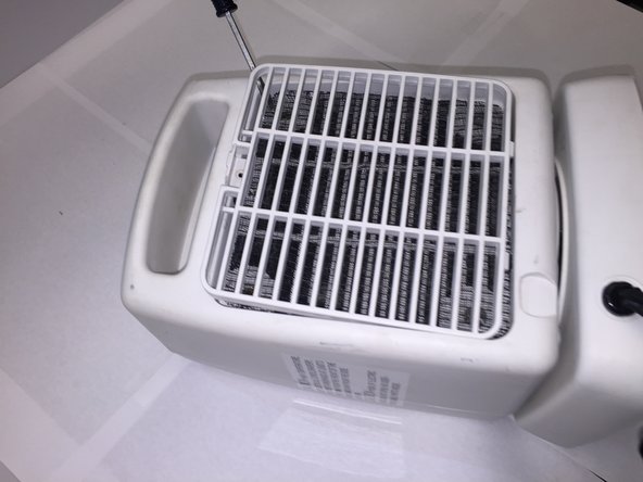

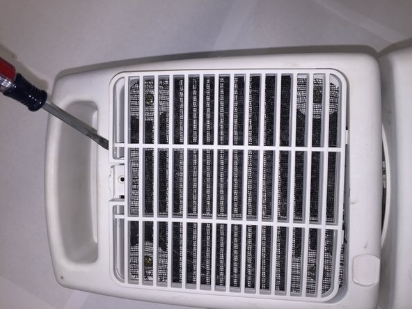

  1. Essential Home HC-409 Teardown, Removed protective grill: crwdns2935265:01crwdnd2935265:01crwdnd2935265:03crwdne2935265:0 Essential Home HC-409 Teardown, Removed protective grill: crwdns2935265:01crwdnd2935265:02crwdnd2935265:03crwdne2935265:0 Essential Home HC-409 Teardown, Removed protective grill: crwdns2935265:01crwdnd2935265:03crwdnd2935265:03crwdne2935265:0
    • Remove the grill from corner to corner.

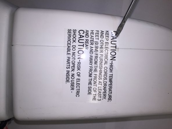

  4. Essential Home HC-409 Teardown, Remove safety sticker: crwdns2935265:04crwdnd2935265:01crwdnd2935265:02crwdne2935265:0 Essential Home HC-409 Teardown, Remove safety sticker: crwdns2935265:04crwdnd2935265:02crwdnd2935265:02crwdne2935265:0
    • Remove sticker in order to open the plastic casing of the heater.

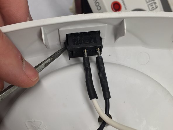

  6. Essential Home HC-409 Teardown, Remove the switch: crwdns2935265:06crwdnd2935265:01crwdnd2935265:02crwdne2935265:0 Essential Home HC-409 Teardown, Remove the switch: crwdns2935265:06crwdnd2935265:02crwdnd2935265:02crwdne2935265:0
    • Apply pressure onto the sides of the switch while pushing it outwards.
