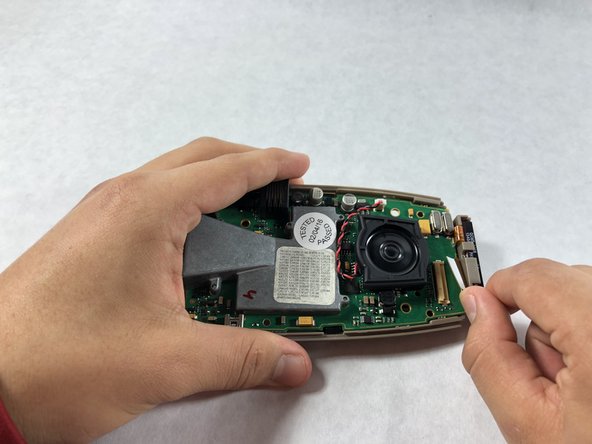

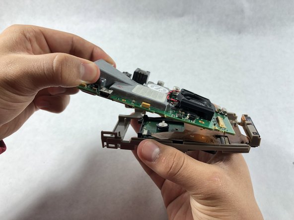

  4. Escort Passport 9500IX Display Replacement: crwdns2935265:04crwdnd2935265:01crwdnd2935265:03crwdne2935265:0 Escort Passport 9500IX Display Replacement: crwdns2935265:04crwdnd2935265:02crwdnd2935265:03crwdne2935265:0 Escort Passport 9500IX Display Replacement: crwdns2935265:04crwdnd2935265:03crwdnd2935265:03crwdne2935265:0
    • Detach the orange flap from the motherboard using a nylon spudger.
    • Carefully remove the motherboard from the grey plastic frame.

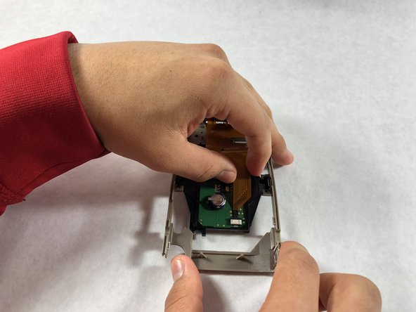

  5. Escort Passport 9500IX Display Replacement: crwdns2935265:05crwdnd2935265:01crwdnd2935265:02crwdne2935265:0 Escort Passport 9500IX Display Replacement: crwdns2935265:05crwdnd2935265:02crwdnd2935265:02crwdne2935265:0
    • Detach the remaining two orange flaps from the circuit board that is attached onto the grey frame.

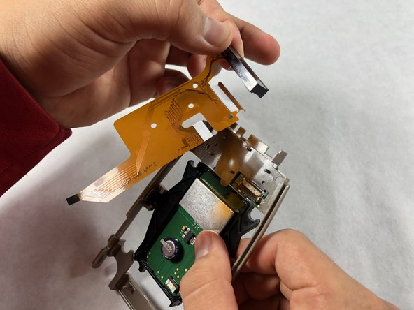

  6. Escort Passport 9500IX Display Replacement: crwdns2935265:06crwdnd2935265:01crwdnd2935265:02crwdne2935265:0 Escort Passport 9500IX Display Replacement: crwdns2935265:06crwdnd2935265:02crwdnd2935265:02crwdne2935265:0
    • Detach the display from the grey frame.
