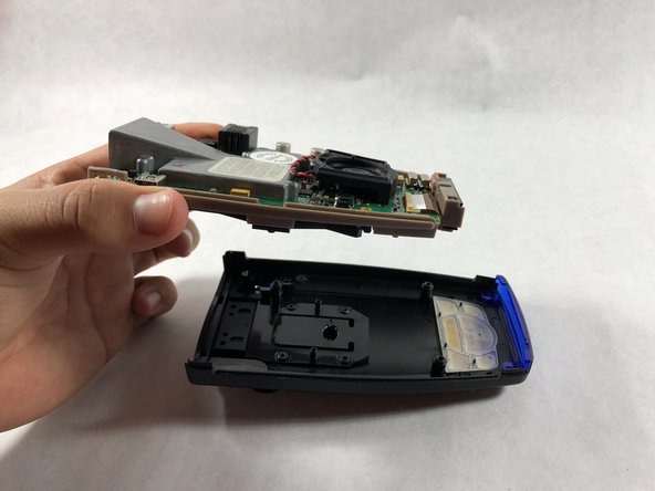

    • Remove the three 1.2 mm Phillips #1 screws on the back of the device.

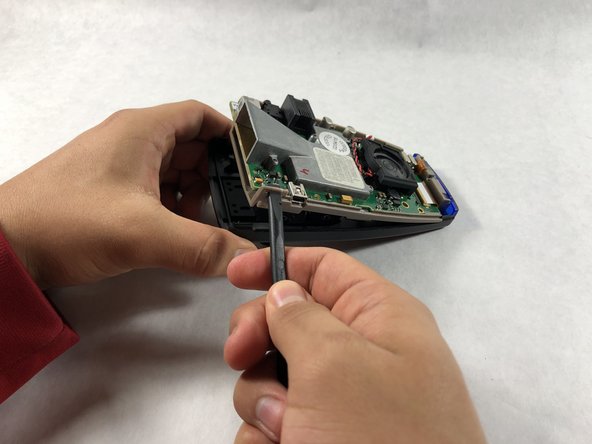

  2. Escort Passport 9500IX Button Replacement: crwdns2935265:02crwdnd2935265:01crwdnd2935265:01crwdne2935265:0
    • Pry off the back panel of the radar using the nylon spudger.
  3. Escort Passport 9500IX Button Replacement, Buttons: crwdns2935265:03crwdnd2935265:01crwdnd2935265:03crwdne2935265:0 Escort Passport 9500IX Button Replacement, Buttons: crwdns2935265:03crwdnd2935265:02crwdnd2935265:03crwdne2935265:0 Escort Passport 9500IX Button Replacement, Buttons: crwdns2935265:03crwdnd2935265:03crwdnd2935265:03crwdne2935265:0
    • Carefully pry the grey frame off the black plastic covering using the nylon spudger.
  4. Escort Passport 9500IX Button Replacement: crwdns2935265:04crwdnd2935265:01crwdnd2935265:02crwdne2935265:0 Escort Passport 9500IX Button Replacement: crwdns2935265:04crwdnd2935265:02crwdnd2935265:02crwdne2935265:0
    • Slowly peel the buttons off the button board.
