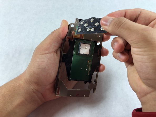

    • Slowly peel the buttons off the button board.

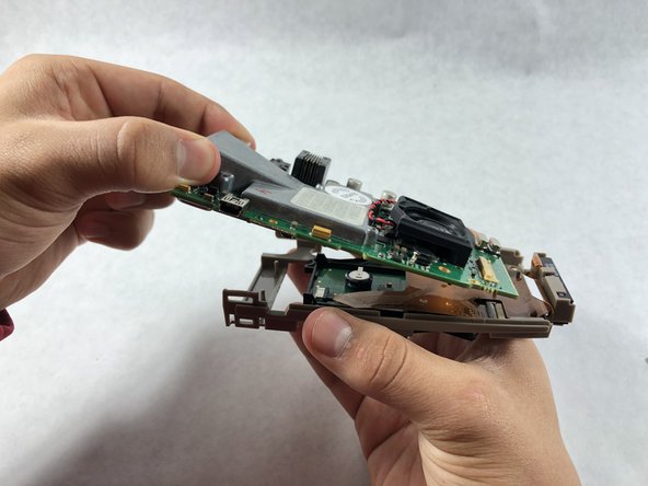

    • Detach the orange flap on the motherboard.
    • Carefully remove the motherboard from the grey plastic frame.

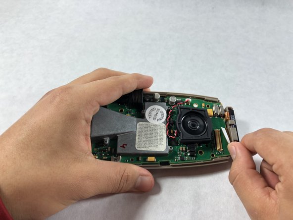

  6. Escort Passport 9500IX Button Board Replacement: crwdns2935265:06crwdnd2935265:01crwdnd2935265:01crwdne2935265:0
    • Detach the orange flap directly behind the button board.

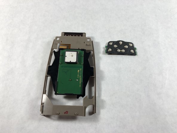

  7. Escort Passport 9500IX Button Board Replacement: crwdns2935265:07crwdnd2935265:01crwdnd2935265:03crwdne2935265:0 Escort Passport 9500IX Button Board Replacement: crwdns2935265:07crwdnd2935265:02crwdnd2935265:03crwdne2935265:0 Escort Passport 9500IX Button Board Replacement: crwdns2935265:07crwdnd2935265:03crwdnd2935265:03crwdne2935265:0
    • Carefully pull out the button board from the grey frame.
