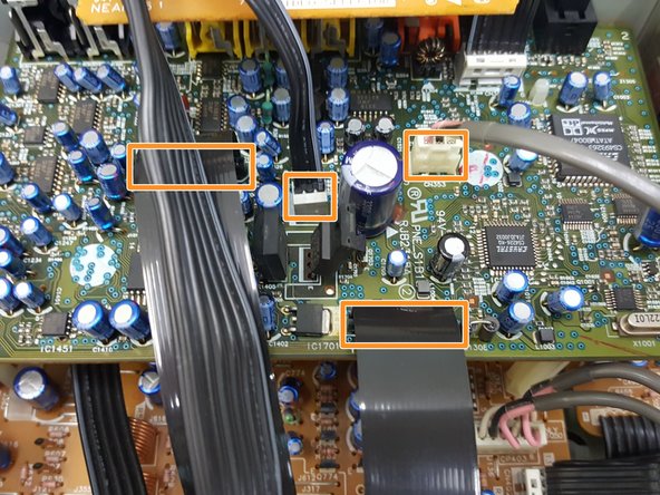

  6. Error F70 Troubleshooting: crwdns2935265:06crwdnd2935265:01crwdnd2935265:03crwdne2935265:0 Error F70 Troubleshooting: crwdns2935265:06crwdnd2935265:02crwdnd2935265:03crwdne2935265:0 Error F70 Troubleshooting: crwdns2935265:06crwdnd2935265:03crwdnd2935265:03crwdne2935265:0
    • Remove six screws securing the Digital Board to the Rear Panel.
    • Remove two flex cables and two other connectors from the Digital Board.
    • Note: If you're having issues removing the connector in the third picture you should be able to rotate the Digital Board after removing everything else then pull up on the white plastic latch.

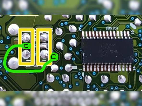

  7. Error F70 Troubleshooting: crwdns2935265:07crwdnd2935265:01crwdnd2935265:02crwdne2935265:0 Error F70 Troubleshooting: crwdns2935265:07crwdnd2935265:02crwdnd2935265:02crwdne2935265:0
    • The marked solder joints tend to crack when exposed to repeated heating and cooling.
    • Make sure that there is a connection between C points in the second picture - if there's a resistance or open line add wire bridge as described with green line from C to C point. This is power so DO NOT use signal wires/kynar.
    • Note: While you have your soldering iron out make sure to inspect pretty much every other solder joint on the board and re-flow it if necessary.

Thank you - barely perceptable break on one of the joints. Reflowed and looking good.
