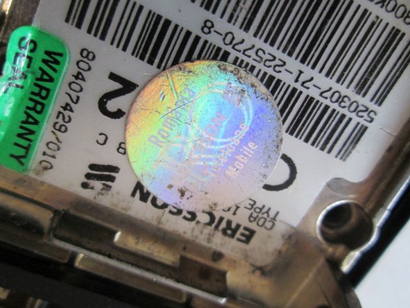

    • Romania version. Oh wow, they made holographic logos for this series.

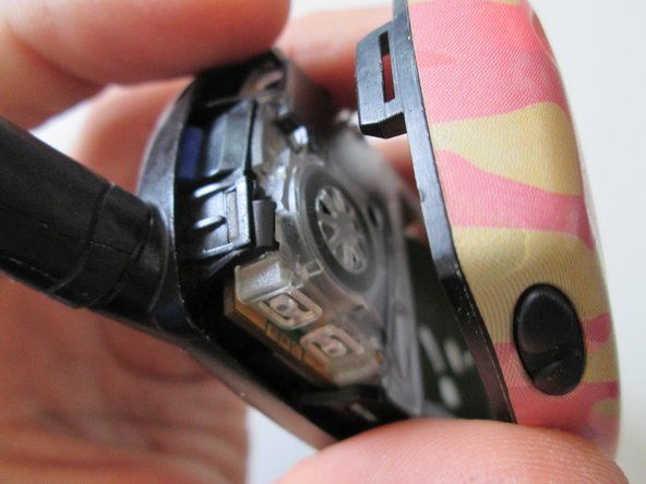

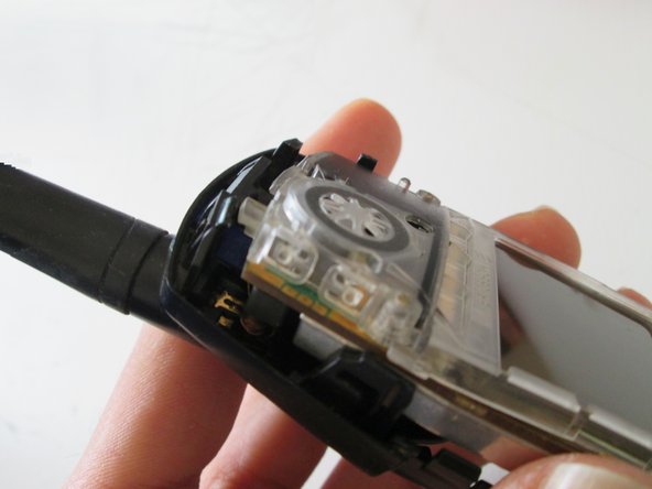

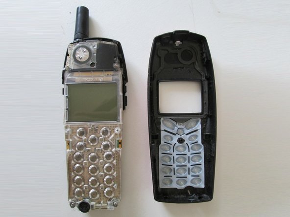

    • To eject the front cover, pull down on the blue switch (as shown in picture one) and then, while holding the switch down, gently pull from the front of the cover as shown in picture two.
    • Front cover off, we can now see the microphone. But it's not reachable from here, there's a transparent plastic body over it.

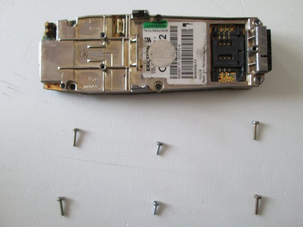

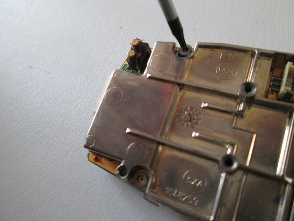

    • Time to remove the metal body off the board. You should easily notice the presence of six T6 screws that need to be removed. Get on it.
    • Notice that two of the screws are of different dimensions and colors when compared to the other four(picture three). Keep that in mind when re-assembling.
  7. Ericsson A2628 Teardown: crwdns2935265:07crwdnd2935265:01crwdnd2935265:03crwdne2935265:0 Ericsson A2628 Teardown: crwdns2935265:07crwdnd2935265:02crwdnd2935265:03crwdne2935265:0 Ericsson A2628 Teardown: crwdns2935265:07crwdnd2935265:03crwdnd2935265:03crwdne2935265:0

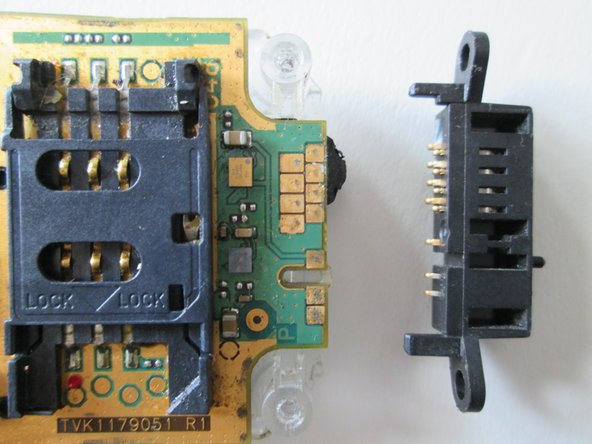

    • The body should go right off without those screws to hold it. Careful, the Charging/data port is not soldiered to the board and may fall out of place.

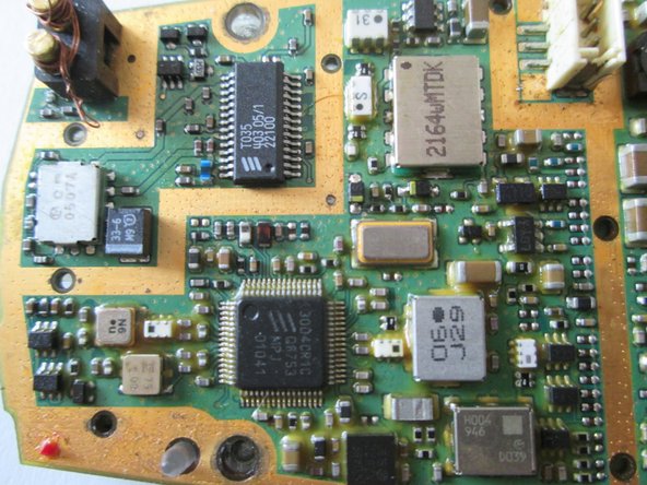

    • 3004CR1C Q8753 MPJ 01041
    • T035 403 05/1 22100
    • ERICSSON 101102/5CR2B 004839AD
    • AU051 PBM 990 28/11 ROP101303011 P1A A9924
    • 1120/8C 0BAH05T RTA

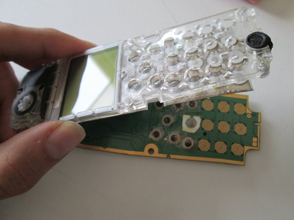

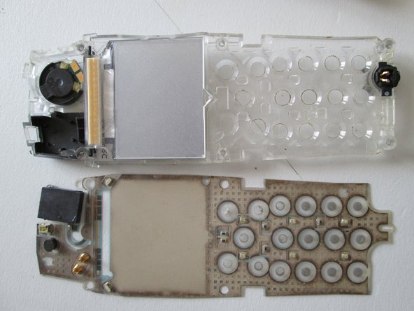

    • Removing the front part from the board, we find the keyboard membrane(here shown with a few quick fixes in picture three)

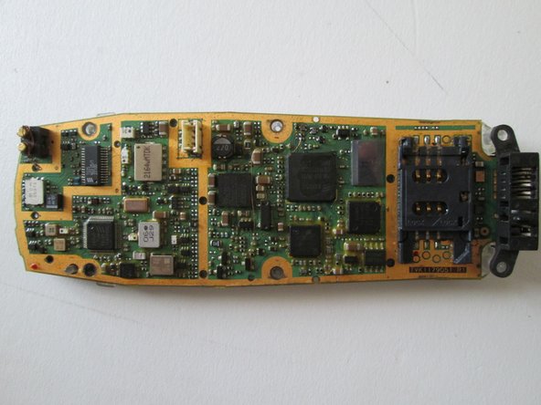

    • Here's some macros of the motherboard.
    • Also there's the bottom connector. it slides right out, so no worries.

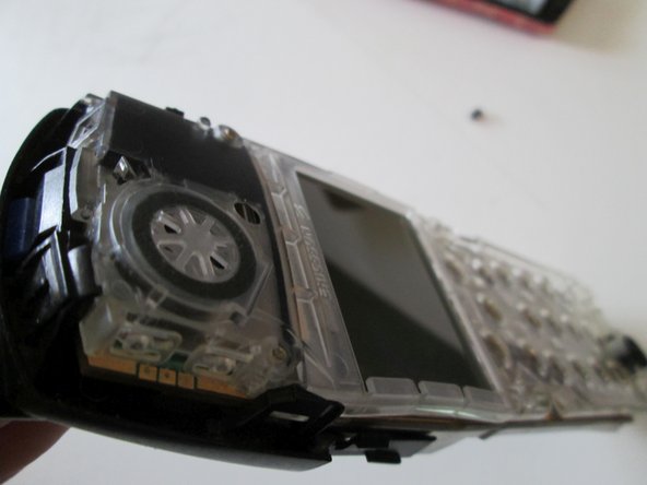

    • The membrane comes off easily from the transparent part, but be careful of the top part where it spirals right next to the speaker. That part comes out harder.
    • 00 H MUT03E N/R STAR
    • Microphone
    • Speaker
    • The screen will now come out if it's pushed from the outside.

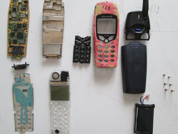

    • And now for a summary of all the parts.
