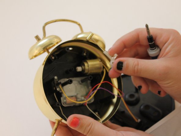

    • Using a Phillips screwdriver, remove the top screw.
    • Repeat for other two screws located on the lower right and left sides of the clock.
  2. Equity Alarm Clock 13014 Clock Hands Replacement, Back Plate and Clock's Inner Apparatus: crwdns2935265:02crwdnd2935265:01crwdnd2935265:01crwdne2935265:0
    • Place fingers on ridge around back plate and pull upward.

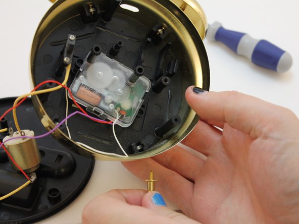

    • Using a Phillips screwdriver, remove the silver base located on top of cellinoid in upper right hand of inner clock.
  4. Equity Alarm Clock 13014 Clock Hands Replacement, The Bell: crwdns2935265:04crwdnd2935265:01crwdnd2935265:02crwdne2935265:0 Equity Alarm Clock 13014 Clock Hands Replacement, The Bell: crwdns2935265:04crwdnd2935265:02crwdnd2935265:02crwdne2935265:0

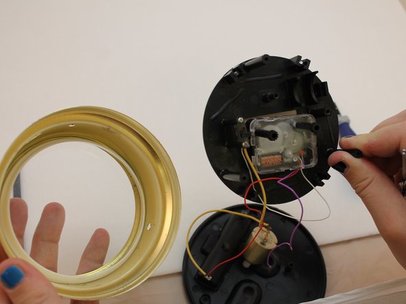

    • Using a Phillips Screwdriver, remove bell from inner clock.

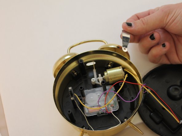

  5. Equity Alarm Clock 13014 Clock Hands Replacement, Cellinoid From Clock: crwdns2935265:05crwdnd2935265:01crwdnd2935265:01crwdne2935265:0
    • Cellinoid is located below Silver Base. Remove Cellinoid with your fingers and pull it up from the inner clock apparatus.

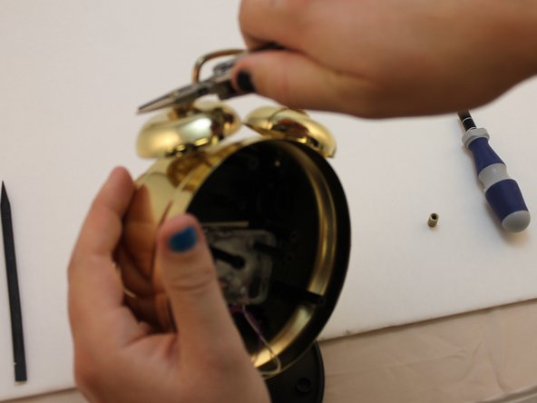

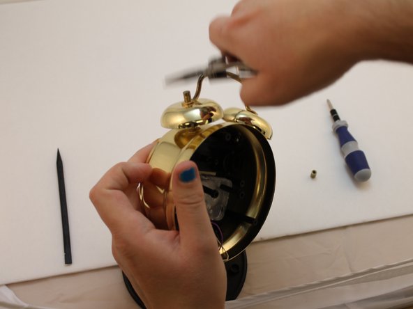

  7. Equity Alarm Clock 13014 Clock Hands Replacement, Right Bell Screw: crwdns2935265:07crwdnd2935265:01crwdnd2935265:02crwdne2935265:0 Equity Alarm Clock 13014 Clock Hands Replacement, Right Bell Screw: crwdns2935265:07crwdnd2935265:02crwdnd2935265:02crwdne2935265:0
    • Using your hands, unscrew top screw located on top of the right bell.
    • Caution: You may need to use a pair of pliers to loosen the screw.

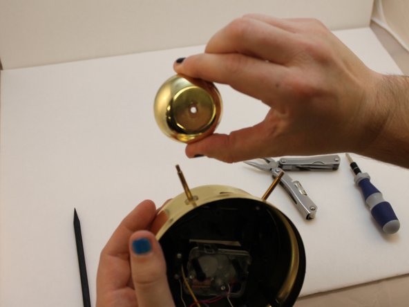

  8. Equity Alarm Clock 13014 Clock Hands Replacement, Left Bell Screw: crwdns2935265:08crwdnd2935265:01crwdnd2935265:03crwdne2935265:0 Equity Alarm Clock 13014 Clock Hands Replacement, Left Bell Screw: crwdns2935265:08crwdnd2935265:02crwdnd2935265:03crwdne2935265:0 Equity Alarm Clock 13014 Clock Hands Replacement, Left Bell Screw: crwdns2935265:08crwdnd2935265:03crwdnd2935265:03crwdne2935265:0
    • Repeat Directions in Step 6 but on the left bell screw.
    • Caution: You may need to use a pair of pliers.

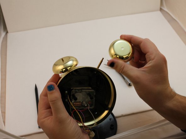

  9. Equity Alarm Clock 13014 Clock Hands Replacement, Bells and Connecting Bar: crwdns2935265:09crwdnd2935265:01crwdnd2935265:03crwdne2935265:0 Equity Alarm Clock 13014 Clock Hands Replacement, Bells and Connecting Bar: crwdns2935265:09crwdnd2935265:02crwdnd2935265:03crwdne2935265:0 Equity Alarm Clock 13014 Clock Hands Replacement, Bells and Connecting Bar: crwdns2935265:09crwdnd2935265:03crwdnd2935265:03crwdne2935265:0
    • After you remove the screws for both bells, both of the two bells and the bar connecting the two bells will easily come off. Remove these three components with your fingers.

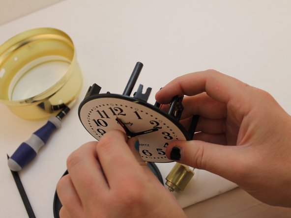

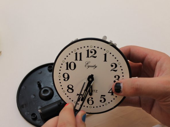

  10. Equity Alarm Clock 13014 Clock Hands Replacement, Remainder of Inner Clock Apparatus: crwdns2935265:010crwdnd2935265:01crwdnd2935265:02crwdne2935265:0 Equity Alarm Clock 13014 Clock Hands Replacement, Remainder of Inner Clock Apparatus: crwdns2935265:010crwdnd2935265:02crwdnd2935265:02crwdne2935265:0
    • Using your hand, remove the entire black, inner apparatus of clock. The golden ridge of the clock is attached to the glass screen.

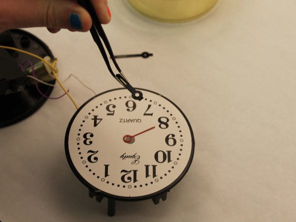

  11. Equity Alarm Clock 13014 Clock Hands Replacement, Inner Clock Apparatus Around and Clock Numbers: crwdns2935265:011crwdnd2935265:01crwdnd2935265:02crwdne2935265:0 Equity Alarm Clock 13014 Clock Hands Replacement, Inner Clock Apparatus Around and Clock Numbers: crwdns2935265:011crwdnd2935265:02crwdnd2935265:02crwdne2935265:0
    • In the front of the clock apparatus are the twelve numbers, minute hand, second hand, and hour hand.
  12. Equity Alarm Clock 13014 Clock Hands Replacement, Clock Hands: crwdns2935265:012crwdnd2935265:01crwdnd2935265:03crwdne2935265:0 Equity Alarm Clock 13014 Clock Hands Replacement, Clock Hands: crwdns2935265:012crwdnd2935265:02crwdnd2935265:03crwdne2935265:0 Equity Alarm Clock 13014 Clock Hands Replacement, Clock Hands: crwdns2935265:012crwdnd2935265:03crwdnd2935265:03crwdne2935265:0
    • Using a pair of tweezers, remove the golden peg in the center of the clock. This attaches the minute, hour and second hands.
    • After you have removed the golden peg, use the pair of tweezers to remove hour, minute and second hands.
