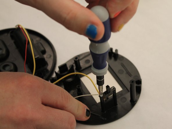

    4. Equity Alarm Clock 13014 Alarm Switch Replacement: crwdns2935265:04crwdnd2935265:01crwdnd2935265:02crwdne2935265:0 Equity Alarm Clock 13014 Alarm Switch Replacement: crwdns2935265:04crwdnd2935265:02crwdnd2935265:02crwdne2935265:0
      • Use a Phillips #1 screwdriver to remove the small screw located above the alarm switch.
      • Remove the small screw located below the alarm switch as well.

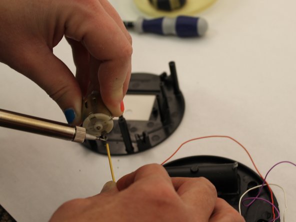

    5. Equity Alarm Clock 13014 Alarm Switch Replacement: crwdns2935265:05crwdnd2935265:01crwdnd2935265:02crwdne2935265:0 Equity Alarm Clock 13014 Alarm Switch Replacement: crwdns2935265:05crwdnd2935265:02crwdnd2935265:02crwdne2935265:0
      • Place the end of the soldering iron on the end of the wire connected to the copper cylinder to detach the wire.
      • If you are unfamiliar with soldering, take a look at this article: How to Solder and Desolder Connections.
      • To replace the alarm switch, attach one end of new alarm switch wire to the copper cylinder.
      • Use a Phillips #1 screwdriver to reinstall the switch screws.
      • Follow steps in reverse order to assemble the clock.
