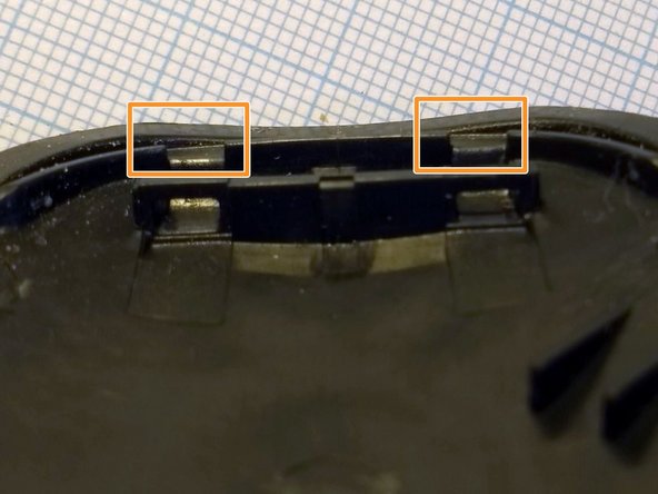

  4. Equestic SaddleClip USB Micro-B Connector and Battery Replacement, Finish front panel removal: crwdns2935265:04crwdnd2935265:01crwdnd2935265:03crwdne2935265:0 Equestic SaddleClip USB Micro-B Connector and Battery Replacement, Finish front panel removal: crwdns2935265:04crwdnd2935265:02crwdnd2935265:03crwdne2935265:0 Equestic SaddleClip USB Micro-B Connector and Battery Replacement, Finish front panel removal: crwdns2935265:04crwdnd2935265:03crwdnd2935265:03crwdne2935265:0
    • There are two hidden clips approximately circled in yellow.
    • Two options for removing panel
    • If you have two thin pins you can try inserting them where the orange arrows are in the first image, through the orange slots in the second image.
    • Or you can gently pull the panel on an angle in the direction of the indicator LED until the clips disengage.
    • The clips and retainers are shown in the second and third images.

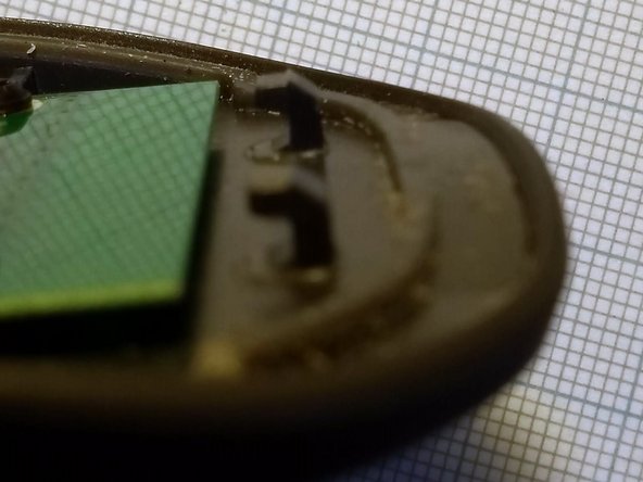

  5. Equestic SaddleClip USB Micro-B Connector and Battery Replacement, Removing back panel: crwdns2935265:05crwdnd2935265:01crwdnd2935265:03crwdne2935265:0 Equestic SaddleClip USB Micro-B Connector and Battery Replacement, Removing back panel: crwdns2935265:05crwdnd2935265:02crwdnd2935265:03crwdne2935265:0 Equestic SaddleClip USB Micro-B Connector and Battery Replacement, Removing back panel: crwdns2935265:05crwdnd2935265:03crwdnd2935265:03crwdne2935265:0
    • The hinge block highlighted in green (with the screws removed in step 3) feels loose, but is still retained with 2 clips
    • If you look down inside the open front, you can just make out two triangular clips located in the yellow circles. These clips hold the hinge block to the PCB.
    • Using some sharp tweezers gently release the pcb clips and the hinge block will release.

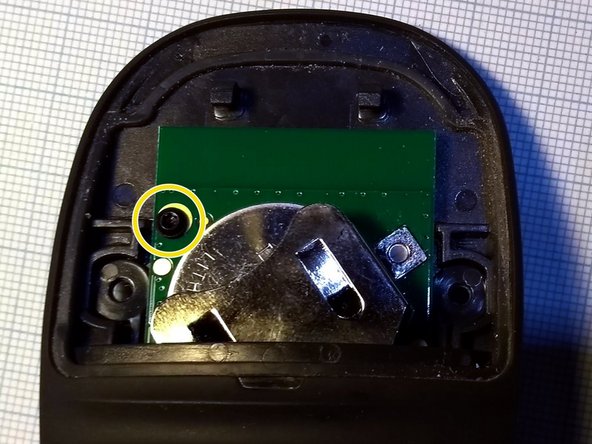

  6. Equestic SaddleClip USB Micro-B Connector and Battery Replacement, Remove PCB: crwdns2935265:06crwdnd2935265:01crwdnd2935265:02crwdne2935265:0 Equestic SaddleClip USB Micro-B Connector and Battery Replacement, Remove PCB: crwdns2935265:06crwdnd2935265:02crwdnd2935265:02crwdne2935265:0
    • Using the T5 driver remove the three screws (one under front panel, and two under hinge block).
    • The PCB will now release easily.

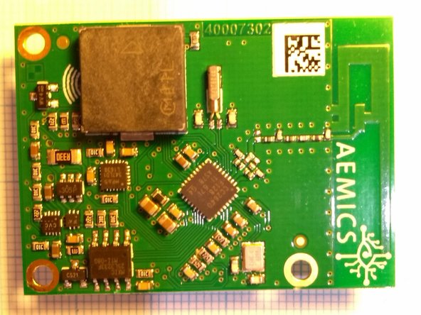

  7. Equestic SaddleClip USB Micro-B Connector and Battery Replacement, Inspection of PCB: crwdns2935265:07crwdnd2935265:01crwdnd2935265:02crwdne2935265:0 Equestic SaddleClip USB Micro-B Connector and Battery Replacement, Inspection of PCB: crwdns2935265:07crwdnd2935265:02crwdnd2935265:02crwdne2935265:0
    • The Li-Ion battery holder is visible on one side, along with the USB Micro-B connector that in this case has been damaged.
    • USB Connector is a Wurth Electronics part #629105136821
    • Battery is a LIR2450 3.6V 120mAh rechargeable Lithium-Ion button cell.
    • The other side of the PCB shows the main components including:
    • CC2640: Texas instruments wireless MCU with Bluetooth
    • MX25L3233FM2I-08G: Macronix 32Mbit Serial Flash
    • MPU-6500: InvenSense 6-Axis motion tracker (3-Axis Gyroscope and 3-Axis Accelerometer)
  8. Equestic SaddleClip USB Micro-B Connector and Battery Replacement, Repair and Replace: crwdns2935265:08crwdnd2935265:01crwdnd2935265:01crwdne2935265:0
    • Repair and replace as required for your circumstances.
    • In this case the USB connector is replaced and reinforced as the locating pads have pulled off the PCB.
    • Note that only pins 1 and 5 are used (VBus and GND). No data connection is present.
