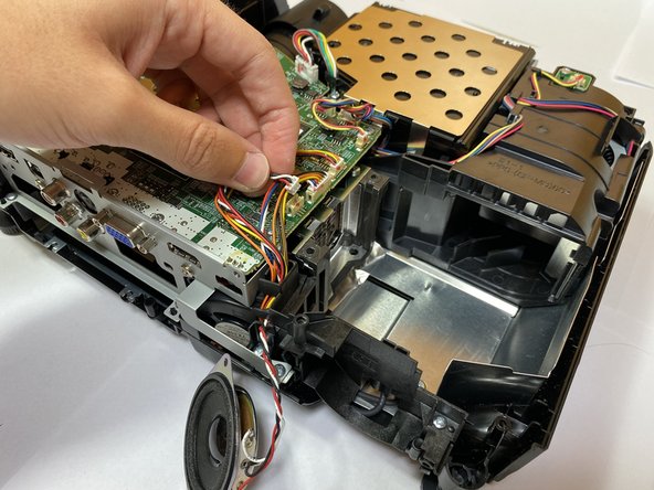

  9. Epson VS250 Speaker Replacement, Speaker: crwdns2935265:09crwdnd2935265:01crwdnd2935265:01crwdne2935265:0
    • Use a Phillips #1 screwdriver to remove the two 10 mm screws holding the speaker in place.
  10. Epson VS250 Speaker Replacement: crwdns2935265:010crwdnd2935265:01crwdnd2935265:02crwdne2935265:0 Epson VS250 Speaker Replacement: crwdns2935265:010crwdnd2935265:02crwdnd2935265:02crwdne2935265:0
    • Pinch and unplug the speaker cable from the motherboard.
    • Remove the speaker from the device.
