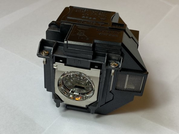

  3. Epson VS250 Lamp Replacement: crwdns2935265:03crwdnd2935265:01crwdnd2935265:01crwdne2935265:0
    • Use a Phillips #1 screwdriver to loosen the two 10 mm screws that hold the lamp in place.
    • The two 10 mm screws do not need to come all the way out. Just ensure they are loose.
  4. Epson VS250 Lamp Replacement: crwdns2935265:04crwdnd2935265:01crwdnd2935265:02crwdne2935265:0 Epson VS250 Lamp Replacement: crwdns2935265:04crwdnd2935265:02crwdnd2935265:02crwdne2935265:0
    • After loosening both screws, remove the lamp from the projector by pulling it up and out.
