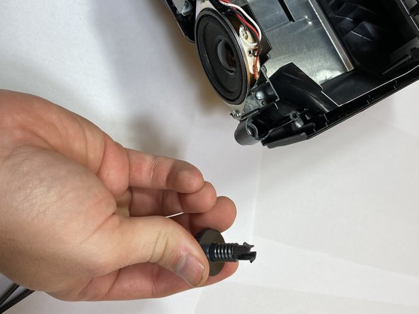

  10. Epson VS250 Feet Replacement: crwdns2935265:010crwdnd2935265:01crwdnd2935265:01crwdne2935265:0
    • Twist the two feet in the counterclockwise direction until both feet are full extended to their maximum lengths.
  11. Epson VS250 Feet Replacement: crwdns2935265:011crwdnd2935265:01crwdnd2935265:02crwdne2935265:0 Epson VS250 Feet Replacement: crwdns2935265:011crwdnd2935265:02crwdnd2935265:02crwdne2935265:0
    • Place the tweezers into the hole where the foot is connected.
    • Use one of your hands to squeeze the tweezers on the top of the foot. Use your free hand to wiggle the bottom of the foot while pulling outward to remove it.
    • Repeat this step for any additional feet.
