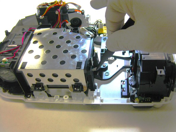

  14. Epson VS240 Stand Replacement, Stand: crwdns2935265:014crwdnd2935265:01crwdnd2935265:02crwdne2935265:0 Epson VS240 Stand Replacement, Stand: crwdns2935265:014crwdnd2935265:02crwdnd2935265:02crwdne2935265:0
    • Using hook nose tweezers, break off the two large prongs that are located at the left and right of the stand at the very top.
    • This can be done by bending them out and snapping them off, pushing them in and out of the way, or a combination of the two. Additionally, if there is no intention to reuse the stand for any other purpose, the entire upper half could be snapped off.

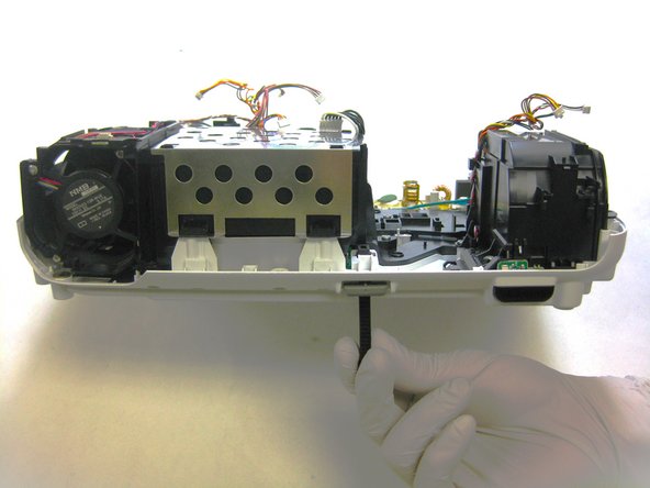

  15. Epson VS240 Stand Replacement: crwdns2935265:015crwdnd2935265:01crwdnd2935265:02crwdne2935265:0 Epson VS240 Stand Replacement: crwdns2935265:015crwdnd2935265:02crwdnd2935265:02crwdne2935265:0
    • Gently raise the front of the projector and push the tab that adjusts the stand upwards. This shall result in the stand extending out of the base of the projector.
    • If the stand does not entirely slide out of the base, grab the part of the stand that has been exposed and pull it until you have removed the entire piece from the base.
    • Keep pushing the tab upwards as you pull the stand out to ensure it is removed as smoothly as possible.
