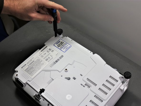

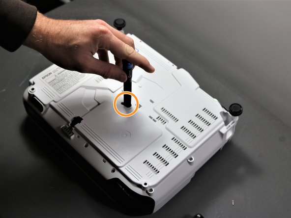

    • Flip the projector over so that the underside (side with the feet) is facing you.
    • Use a Phillips #1 screwdriver to remove five 10 mm screws on the underside of projector.
    • Using the same Phillips #1 screwdriver, remove a single 10 mm screw in the center hole.
    • You may need to use a screwdriver extender to reach the single screw.

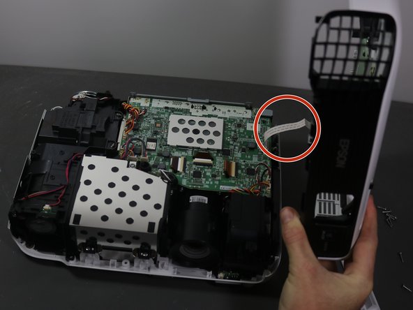

  7. Epson VS240 Shell Replacement: crwdns2935265:07crwdnd2935265:01crwdnd2935265:02crwdne2935265:0 Epson VS240 Shell Replacement: crwdns2935265:07crwdnd2935265:02crwdnd2935265:02crwdne2935265:0
    • Be careful when removing the top cover of projector as there is as white ribbon cable connecting it to the motherboard.
    • Gently lift top cover and place it on its top next to the projector so that the ribbon has no tension on it.
    • Gently pull the brown tape connecting the cable to the motherboard and then remove the shell from the device.
