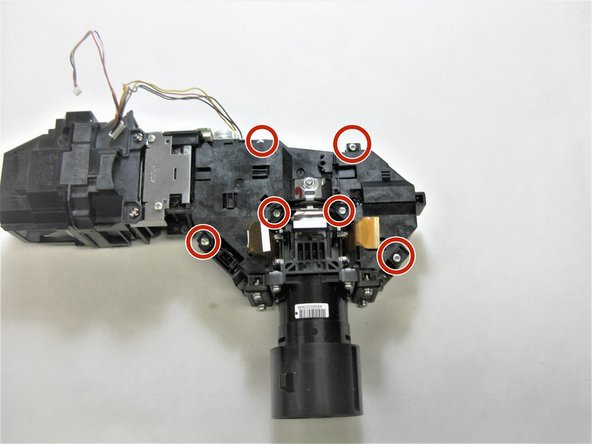

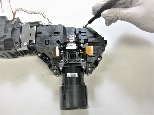

  14. Epson VS240 Color Prism Replacement, Prisms: crwdns2935265:014crwdnd2935265:01crwdnd2935265:03crwdne2935265:0 Epson VS240 Color Prism Replacement, Prisms: crwdns2935265:014crwdnd2935265:02crwdnd2935265:03crwdne2935265:0 Epson VS240 Color Prism Replacement, Prisms: crwdns2935265:014crwdnd2935265:03crwdnd2935265:03crwdne2935265:0
    • Use a Phillips #1 screwdriver to detach the upper plastic cover by unscrewing the six 11 mm screws.
    • Once the six screws are removed, lift the plastic cover and place it off to the side.
    • When the screws are out, the covering is be very loose, so there is no particular way that it needs to be taken off.

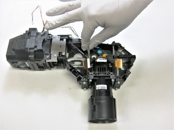

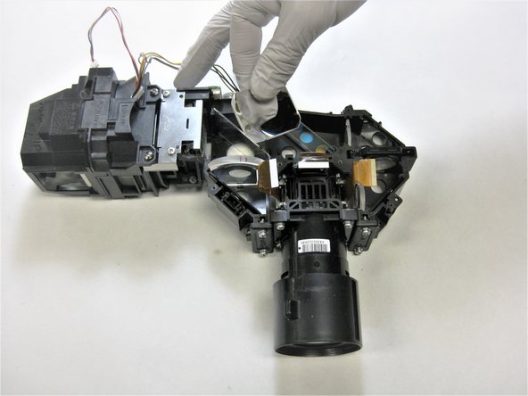

  15. Epson VS240 Color Prism Replacement: crwdns2935265:015crwdnd2935265:01crwdnd2935265:03crwdne2935265:0 Epson VS240 Color Prism Replacement: crwdns2935265:015crwdnd2935265:02crwdnd2935265:03crwdne2935265:0 Epson VS240 Color Prism Replacement: crwdns2935265:015crwdnd2935265:03crwdnd2935265:03crwdne2935265:0
    • Be careful with the prisms, as they may shatter and prove dangerous if not handled gently.
    • Gently remove the three prisms.
    • These prisms are made of glass and are easy to smudge, and so it is recommended that you wear gloves when handling any new prism that is being inserted.
