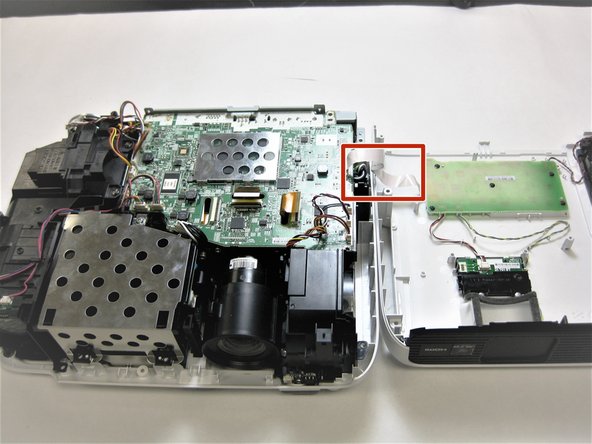

  7. Epson VS240 Buttons Replacement: crwdns2935265:07crwdnd2935265:01crwdnd2935265:02crwdne2935265:0 Epson VS240 Buttons Replacement: crwdns2935265:07crwdnd2935265:02crwdnd2935265:02crwdne2935265:0
    • Be careful when removing the top cover of projector as there is as white ribbon cable connecting it to the motherboard.
    • Gently lift top cover and place it on its top next to the projector so that the ribbon has no tension on it.
    • Gently pull the brown tape connecting the cable to the motherboard and then remove the shell from the device.

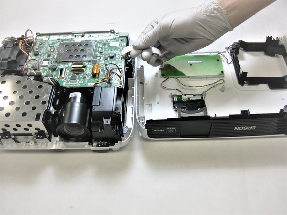

  8. Epson VS240 Buttons Replacement, Buttons: crwdns2935265:08crwdnd2935265:01crwdnd2935265:03crwdne2935265:0 Epson VS240 Buttons Replacement, Buttons: crwdns2935265:08crwdnd2935265:02crwdnd2935265:03crwdne2935265:0 Epson VS240 Buttons Replacement, Buttons: crwdns2935265:08crwdnd2935265:03crwdnd2935265:03crwdne2935265:0
    • Gently disconnect the white ribbon cable connecting the motherboard to the button panel.

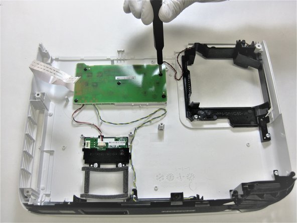

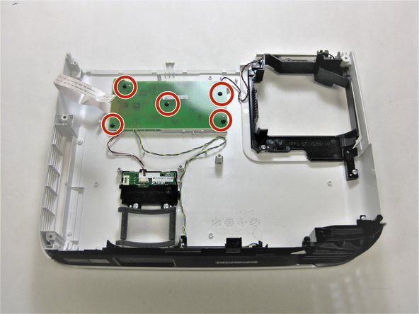

  9. Epson VS240 Buttons Replacement: crwdns2935265:09crwdnd2935265:01crwdnd2935265:03crwdne2935265:0 Epson VS240 Buttons Replacement: crwdns2935265:09crwdnd2935265:02crwdnd2935265:03crwdne2935265:0 Epson VS240 Buttons Replacement: crwdns2935265:09crwdnd2935265:03crwdnd2935265:03crwdne2935265:0
    • Use a Phillips #1 screwdriver to remove the five 3 mm screws securing the button panel to the shell.

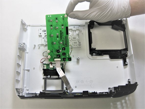

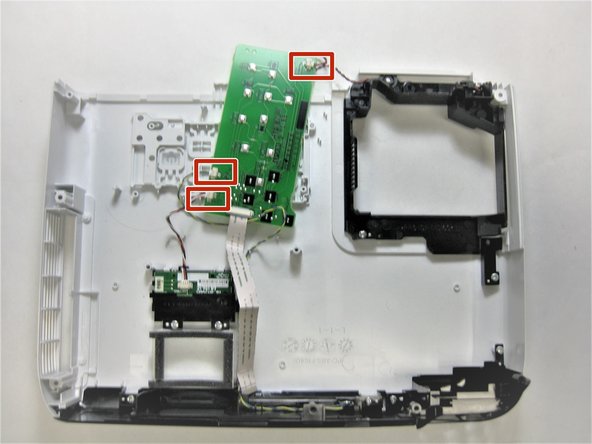

  10. Epson VS240 Buttons Replacement: crwdns2935265:010crwdnd2935265:01crwdnd2935265:03crwdne2935265:0 Epson VS240 Buttons Replacement: crwdns2935265:010crwdnd2935265:02crwdnd2935265:03crwdne2935265:0 Epson VS240 Buttons Replacement: crwdns2935265:010crwdnd2935265:03crwdnd2935265:03crwdne2935265:0
    • Disconnect the three cables connected to the button panel.
    • Lift the button panel up and out.
