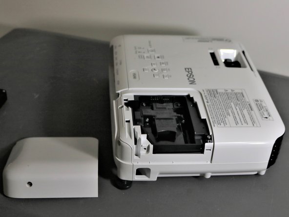

    3. Epson VS240 Bulb Replacement: crwdns2935265:03crwdnd2935265:01crwdnd2935265:02crwdne2935265:0 Epson VS240 Bulb Replacement: crwdns2935265:03crwdnd2935265:02crwdnd2935265:02crwdne2935265:0
      • Carefully slide the cover and lift it off the device.
      • Again, be careful of any broken parts within the device.
    4. Epson VS240 Bulb Replacement: crwdns2935265:04crwdnd2935265:01crwdnd2935265:03crwdne2935265:0 Epson VS240 Bulb Replacement: crwdns2935265:04crwdnd2935265:02crwdnd2935265:03crwdne2935265:0 Epson VS240 Bulb Replacement: crwdns2935265:04crwdnd2935265:03crwdnd2935265:03crwdne2935265:0
      • Use the Phillips #2 screwdriver to loosen the screws attaching the bulb to the projector.
      • You only need to loosen the screws since they do not remove from the bulb completely.

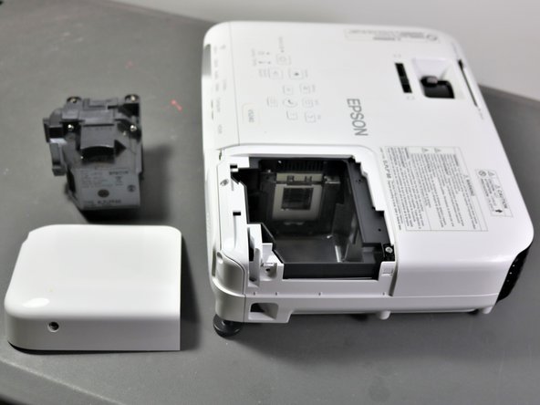

    5. Epson VS240 Bulb Replacement: crwdns2935265:05crwdnd2935265:01crwdnd2935265:02crwdne2935265:0 Epson VS240 Bulb Replacement: crwdns2935265:05crwdnd2935265:02crwdnd2935265:02crwdne2935265:0
      • Once the bulb has been loosened, grab the raised section of the bulb and carefully lift the bulb up and away from the device.
Be gentle when inserting the new bulb. If you feel any resistance when inserting the replacement bulb, chances are that you inserted it the wrong way. This is a common mistake. Turn it around, making it face the right direction, before again inserting it into the device.
Be careful when screwing components back into the device since over-screwing can result in damage to the pieces.
