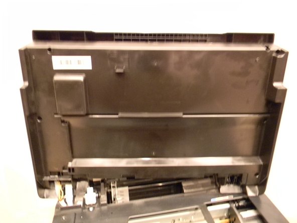

    3. Epson Stylus NX305 Scanner Motor Replacement: crwdns2935265:03crwdnd2935265:01crwdnd2935265:02crwdne2935265:0 Epson Stylus NX305 Scanner Motor Replacement: crwdns2935265:03crwdnd2935265:02crwdnd2935265:02crwdne2935265:0
      • Open up the lid of the printer.
      • With the printer facing away from you, lift up on the right hand side of the lid of the printer and slide it to the left to remove it.
      • Be careful not to remove the white ribbon and wires that are connected.
