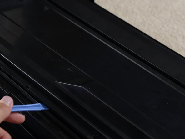

  5. Epson Stylus NX230 Scanner Motor Replacement: crwdns2935265:05crwdnd2935265:01crwdnd2935265:02crwdne2935265:0 Epson Stylus NX230 Scanner Motor Replacement: crwdns2935265:05crwdnd2935265:02crwdnd2935265:02crwdne2935265:0
    • Locate the seam on between outer shell of the printer and the inside of the printer.
    • Starting from the top of the printer, use the plastic opening tool to slowly pry the scanner apart along the seam.

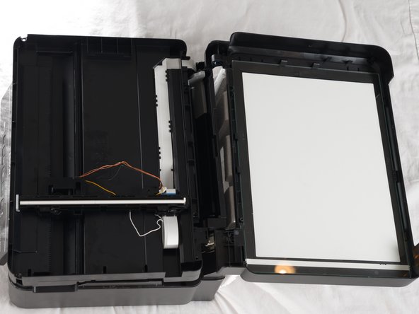

  6. Epson Stylus NX230 Scanner Motor Replacement: crwdns2935265:06crwdnd2935265:01crwdnd2935265:02crwdne2935265:0 Epson Stylus NX230 Scanner Motor Replacement: crwdns2935265:06crwdnd2935265:02crwdnd2935265:02crwdne2935265:0
    • Detach the bottom of the scanner.
    • Flip the bottom of the scanner over so that it rests on top of the printer.
    • This gives you access to the motor.
  7. Epson Stylus NX230 Scanner Motor Replacement: crwdns2935265:07crwdnd2935265:01crwdnd2935265:01crwdne2935265:0
    • Gently lift the scanner bar in order to remove it from the scanner.
    • Detach the white ribbon cable from the scanner bar.
  8. Epson Stylus NX230 Scanner Motor Replacement: crwdns2935265:08crwdnd2935265:01crwdnd2935265:01crwdne2935265:0
    • Remove the two 3mm Phillips #2 screws on the underside of the scanner bar attached to the silver motor.
    • Remove the motor from the scanner bar by gently pulling the motor upwards.
