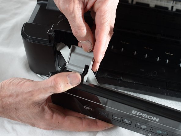

      • Locate the control panel, the part of the printer with the buttons on it.
      • Push the control panel away from the outside of the printer, taking the panel out of the holes that hold it in place.
      • Repeat the above step for the other side of the control panel.
    3. Epson Stylus NX230 Front Button Replacement: crwdns2935265:03crwdnd2935265:01crwdnd2935265:02crwdne2935265:0 Epson Stylus NX230 Front Button Replacement: crwdns2935265:03crwdnd2935265:02crwdnd2935265:02crwdne2935265:0
      • The front control panel is attached to the printer on both sides by a grey piece of plastic that runs on a track. Remove the control panel from the track by pushing it away from the track on both sides.
      • The ribbon cable on the left side of the control panel, also known as the ribbon cable, must stay attached to the printer. If the cable becomes detached the front buttons will not be responsive.

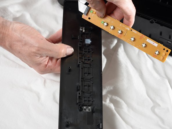

      • Split the control panel in half by gently pulling on both sides of the seam that runs through the control panel.
    7. Epson Stylus NX230 Front Button Replacement: crwdns2935265:07crwdnd2935265:01crwdnd2935265:02crwdne2935265:0 Epson Stylus NX230 Front Button Replacement: crwdns2935265:07crwdnd2935265:02crwdnd2935265:02crwdne2935265:0
      • Separate the two pieces to reveal the green circuit board.
      • Be sure to not detach the circuit board from the white tap.
      • Remove the green circuit board by lifting it up gently with your hands.
    8. Epson Stylus NX230 Front Button Replacement: crwdns2935265:08crwdnd2935265:01crwdnd2935265:01crwdne2935265:0
      • Remove the buttons with the plastic opening tool by pressing the front panel down and lifting the buttons up.
