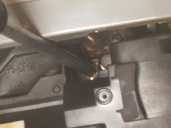

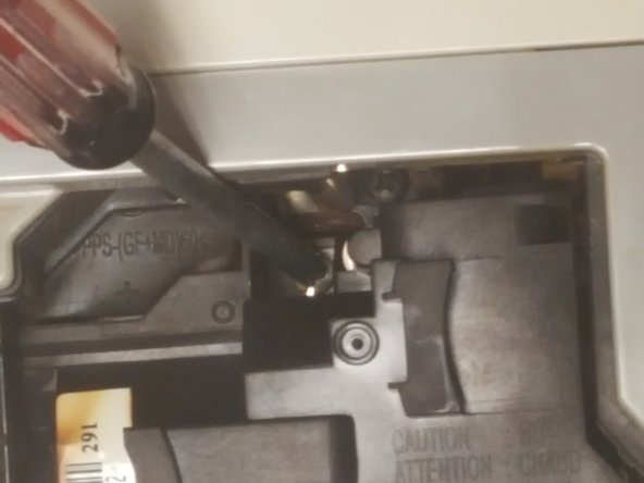

    • Locate the two screws on either side of the projection lamp.
    • Using a Phillip's head screwdriver, loosen the two screws.
    • The screws only loosen. You don't have to worry about them falling out.
