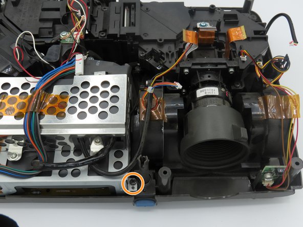

  9. Epson Powerlite S4 Front Adjustable Foot Replacement, Front Adjustable Foot: crwdns2935265:09crwdnd2935265:01crwdnd2935265:02crwdne2935265:0 Epson Powerlite S4 Front Adjustable Foot Replacement, Front Adjustable Foot: crwdns2935265:09crwdnd2935265:02crwdnd2935265:02crwdne2935265:0
    • To the left of the lens, you'll find the adjustable foot.
    • Remove the screw to the left of the adjustable foot using a Phillips #0 screwdriver.
    • Lift up the adjustable foot to remove it from the projector.
