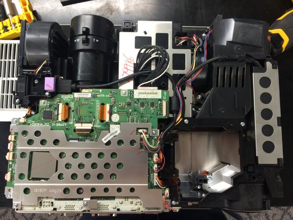

  3. Epson Powerlite 915W Projector Lamp Ballast Replacement, Opening the Case: crwdns2935265:03crwdnd2935265:01crwdnd2935265:03crwdne2935265:0 Epson Powerlite 915W Projector Lamp Ballast Replacement, Opening the Case: crwdns2935265:03crwdnd2935265:02crwdnd2935265:03crwdne2935265:0 Epson Powerlite 915W Projector Lamp Ballast Replacement, Opening the Case: crwdns2935265:03crwdnd2935265:03crwdnd2935265:03crwdne2935265:0
    • Remove 7 screws from the bottom. These are all the same size and thread.
    • Remove 5 screws from back panel. These are all the same as well (not the same as the ones on the bottom).
    • Lift the panel off.
    • When reassembling, it helps to save this step for after the top of the case is back together.

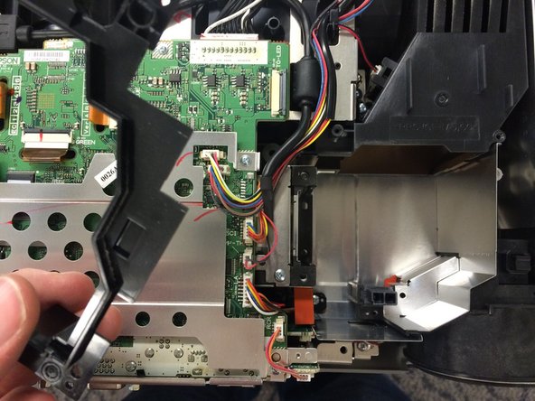

  4. Epson Powerlite 915W Projector Lamp Ballast Replacement, Remove the Ribbon Cable: crwdns2935265:04crwdnd2935265:01crwdnd2935265:02crwdne2935265:0 Epson Powerlite 915W Projector Lamp Ballast Replacement, Remove the Ribbon Cable: crwdns2935265:04crwdnd2935265:02crwdnd2935265:02crwdne2935265:0
    • Disconnect the ribbon cable connected to the LEDs on the outside of the case.
  5. Epson Powerlite 915W Projector Lamp Ballast Replacement, Remove Lamp Area Bezel: crwdns2935265:05crwdnd2935265:01crwdnd2935265:02crwdne2935265:0 Epson Powerlite 915W Projector Lamp Ballast Replacement, Remove Lamp Area Bezel: crwdns2935265:05crwdnd2935265:02crwdnd2935265:02crwdne2935265:0
    • There are 3 screws in this area that need removed. 2 are the same and then 1 is unique (marked with blue).
    • Lift the bezel straight up.

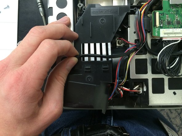

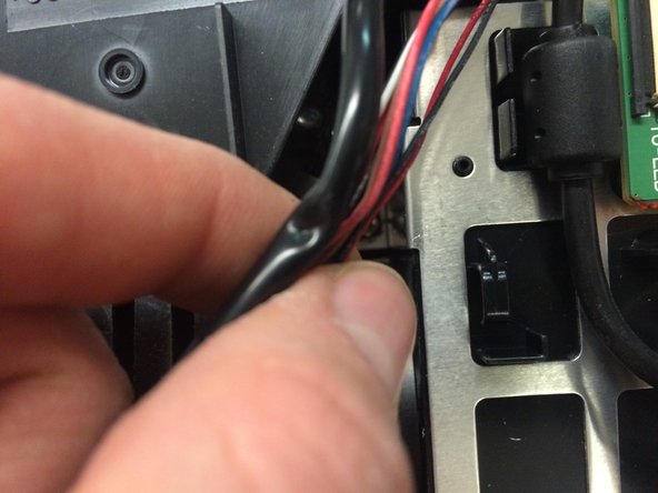

  6. Epson Powerlite 915W Projector Lamp Ballast Replacement, Moving the Fan and Vent: crwdns2935265:06crwdnd2935265:01crwdnd2935265:03crwdne2935265:0 Epson Powerlite 915W Projector Lamp Ballast Replacement, Moving the Fan and Vent: crwdns2935265:06crwdnd2935265:02crwdnd2935265:03crwdne2935265:0 Epson Powerlite 915W Projector Lamp Ballast Replacement, Moving the Fan and Vent: crwdns2935265:06crwdnd2935265:03crwdnd2935265:03crwdne2935265:0
    • Remove 2 screws from the vent.
    • Pull wires off top of the vent and out of the channel to the side of the vent.
    • When you lift the fan, it will all come up as one piece, but still have wires connected. You don't need to remove the whole unit, just movie it to the side. You will have to wiggle it out from under the cable that crosses over the top of it.
  7. Epson Powerlite 915W Projector Lamp Ballast Replacement, Set Fan and Vent Assembly to the side: crwdns2935265:07crwdnd2935265:01crwdnd2935265:01crwdne2935265:0
    • Move the assembly out of the way.

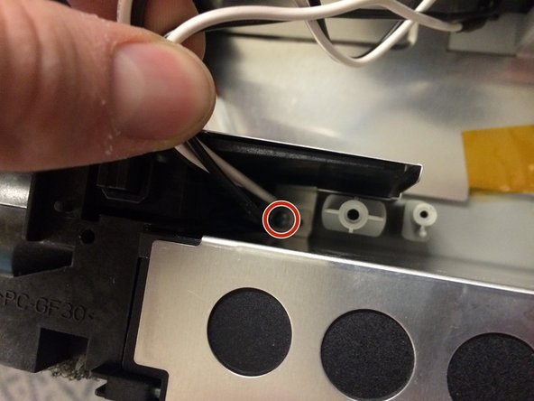

  8. Epson Powerlite 915W Projector Lamp Ballast Replacement, Unscrew Lamp Ballast: crwdns2935265:08crwdnd2935265:01crwdnd2935265:02crwdne2935265:0 Epson Powerlite 915W Projector Lamp Ballast Replacement, Unscrew Lamp Ballast: crwdns2935265:08crwdnd2935265:02crwdnd2935265:02crwdne2935265:0
    • Remove the 2 screws from the front and back of the lamp ballast holder.

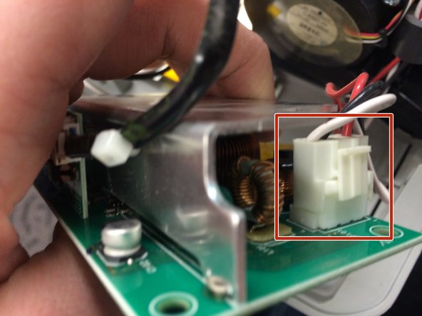

  9. Epson Powerlite 915W Projector Lamp Ballast Replacement, Disconnect the Ballast: crwdns2935265:09crwdnd2935265:01crwdnd2935265:03crwdne2935265:0 Epson Powerlite 915W Projector Lamp Ballast Replacement, Disconnect the Ballast: crwdns2935265:09crwdnd2935265:02crwdnd2935265:03crwdne2935265:0 Epson Powerlite 915W Projector Lamp Ballast Replacement, Disconnect the Ballast: crwdns2935265:09crwdnd2935265:03crwdnd2935265:03crwdne2935265:0
    • Lift the ballast and holder up in the back and slide it to where the blue plug is visible and then disconnect it.
    • Now you can slide the ballast out of the holder and disconnect the remaining 2 connections.
