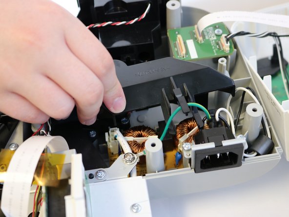

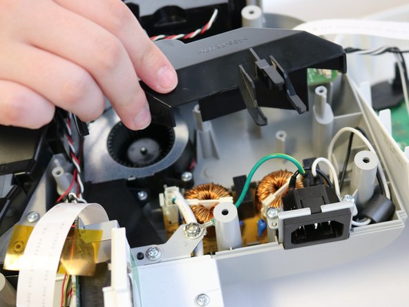

  3. Epson Powerlite 460 Power Supply Replacement: crwdns2935265:03crwdnd2935265:01crwdnd2935265:03crwdne2935265:0 Epson Powerlite 460 Power Supply Replacement: crwdns2935265:03crwdnd2935265:02crwdnd2935265:03crwdne2935265:0 Epson Powerlite 460 Power Supply Replacement: crwdns2935265:03crwdnd2935265:03crwdnd2935265:03crwdne2935265:0
    • Using the Phillips #2 screwdriver, remove the six 13.3 mm screws on the ABS black cover and AC power inlet above the power supply.
    • Lift up cover and inlet and set to the side.

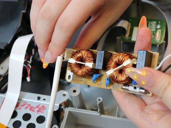

  4. Epson Powerlite 460 Power Supply Replacement: crwdns2935265:04crwdnd2935265:01crwdnd2935265:02crwdne2935265:0 Epson Powerlite 460 Power Supply Replacement: crwdns2935265:04crwdnd2935265:02crwdnd2935265:02crwdne2935265:0
    • Using the Phillips #2 screwdriver, remove the 7.7 mm screw attached to the ring terminal.
  5. Epson Powerlite 460 Power Supply Replacement: crwdns2935265:05crwdnd2935265:01crwdnd2935265:01crwdne2935265:0
    • Using the opening tool, unclip the white clip cable by pressing the side tabs.
  6. Epson Powerlite 460 Power Supply Replacement: crwdns2935265:06crwdnd2935265:01crwdnd2935265:02crwdne2935265:0 Epson Powerlite 460 Power Supply Replacement: crwdns2935265:06crwdnd2935265:02crwdnd2935265:02crwdne2935265:0
    • Using the opening tool or a spudger, unclip the power supply from the base.
    • Remove the power supply.
