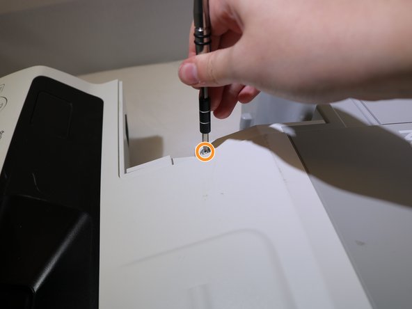

      • Remove the two 13.3mm screws from the top cover above the air filter using a Phillips #2 screwdriver.
      • Remove one 13.3mm screw from above the connection panel using a Phillips #2 screwdriver.

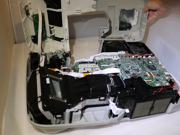

    4. Epson Powerlite 460 Fan Replacement: crwdns2935265:04crwdnd2935265:01crwdnd2935265:02crwdne2935265:0 Epson Powerlite 460 Fan Replacement: crwdns2935265:04crwdnd2935265:02crwdnd2935265:02crwdne2935265:0
      • Remove the cover from the projector and set aside.
      • The cover will be connected by ribbon cables. You do not need to disconnect these to complete this repair, but it may make it easier.
    5. Epson Powerlite 460 Fan Replacement: crwdns2935265:05crwdnd2935265:01crwdnd2935265:03crwdne2935265:0 Epson Powerlite 460 Fan Replacement: crwdns2935265:05crwdnd2935265:02crwdnd2935265:03crwdne2935265:0 Epson Powerlite 460 Fan Replacement: crwdns2935265:05crwdnd2935265:03crwdnd2935265:03crwdne2935265:0
      • Use the opening tool to disconnect eleven clip cables on the motherboard.
      • These will be the colorful cables connected with white plastic clips.
      • Disconnect the black cable clip by pressing the side tabs. Use the opening tool to release the cable if it is difficult.
      • To disconnect the ribbon cables, use the opening tool to lift the locking flap on the connector and slide the cable back and out of the connector.

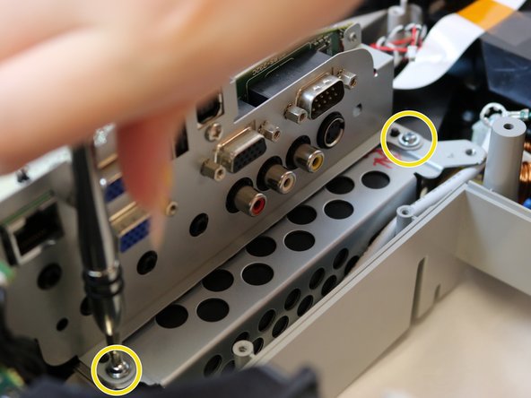

    6. Epson Powerlite 460 Fan Replacement: crwdns2935265:06crwdnd2935265:01crwdnd2935265:01crwdne2935265:0
      • Disconnect the clip cable from below the motherboard and behind the connection panel.
    7. Epson Powerlite 460 Fan Replacement: crwdns2935265:07crwdnd2935265:01crwdnd2935265:03crwdne2935265:0 Epson Powerlite 460 Fan Replacement: crwdns2935265:07crwdnd2935265:02crwdnd2935265:03crwdne2935265:0 Epson Powerlite 460 Fan Replacement: crwdns2935265:07crwdnd2935265:03crwdnd2935265:03crwdne2935265:0

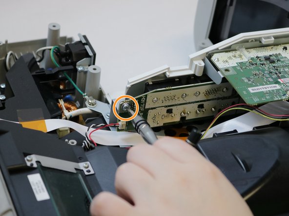

      • Remove seven 8.1mm screws from the motherboard using a Phillips #2 screwdriver.
      • Remove the 8.1mm screw from the back of the projection panel below the motherboard using a Phillips #2 screwdriver.
      • Remove two 8.1mm screws from the front of the projection panel using a Phillips #2 screwdriver.

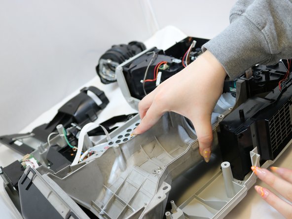

    8. Epson Powerlite 460 Fan Replacement: crwdns2935265:08crwdnd2935265:01crwdnd2935265:01crwdne2935265:0
      • Gently lift the motherboard out of the device.

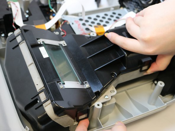

    1. Epson Powerlite 460 Fan Replacement, Lens: crwdns2935265:09crwdnd2935265:01crwdnd2935265:02crwdne2935265:0 Epson Powerlite 460 Fan Replacement, Lens: crwdns2935265:09crwdnd2935265:02crwdnd2935265:02crwdne2935265:0

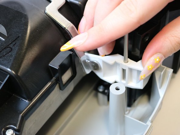

      • Use a Phillips #0 screwdriver to remove the two 9.1mm screws from the focus lever adjuster.
      • Remove the focus lever mechanism by sliding the metal rod out of the plastic lever and lifting out of the unit.
    2. Epson Powerlite 460 Fan Replacement: crwdns2935265:010crwdnd2935265:01crwdnd2935265:02crwdne2935265:0 Epson Powerlite 460 Fan Replacement: crwdns2935265:010crwdnd2935265:02crwdnd2935265:02crwdne2935265:0

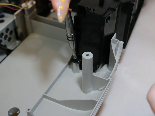

      • Remove the two 13.3mm screws from the metal bracket surrounding the lens unit using a Phillips #0 screwdriver.
      • Remove the bracket.
    3. Epson Powerlite 460 Fan Replacement: crwdns2935265:011crwdnd2935265:01crwdnd2935265:02crwdne2935265:0 Epson Powerlite 460 Fan Replacement: crwdns2935265:011crwdnd2935265:02crwdnd2935265:02crwdne2935265:0
      • Remove the two 13.3mm screws from the lens cover using a Phillips #0 screwdriver.
      • Use your finger to release the clips on either side of the lens cover.
      • Lift the lens cover to remove it from the projector.
    4. Epson Powerlite 460 Fan Replacement: crwdns2935265:012crwdnd2935265:01crwdnd2935265:02crwdne2935265:0 Epson Powerlite 460 Fan Replacement: crwdns2935265:012crwdnd2935265:02crwdnd2935265:02crwdne2935265:0
      • Remove the five 9.4mm screws from the lens using a Phillips #0 screwdriver.
      • Lift the lens out of the unit.

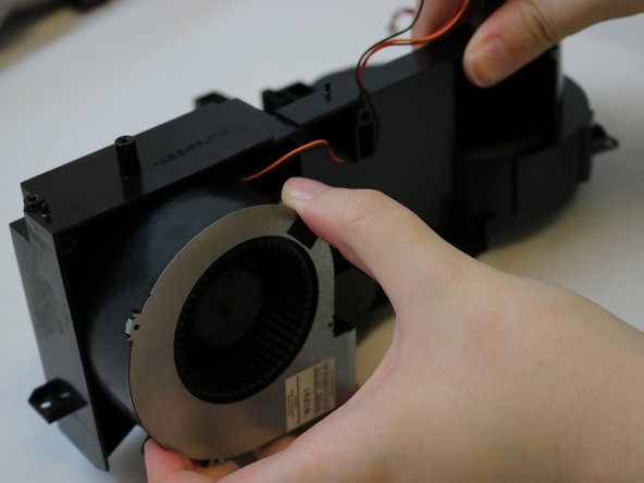

      • Remove the two 13.4 mm screws from the fan.
      • Remove the fan.
