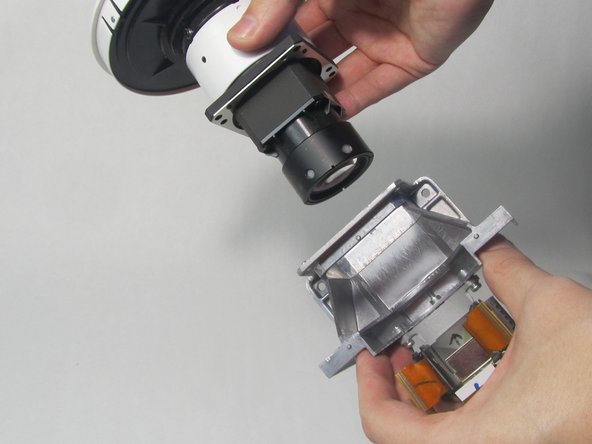

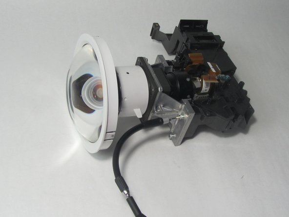

    1. Epson Powerlite 410W Lens Replacement, Lens: crwdns2935265:08crwdnd2935265:01crwdnd2935265:02crwdne2935265:0 Epson Powerlite 410W Lens Replacement, Lens: crwdns2935265:08crwdnd2935265:02crwdnd2935265:02crwdne2935265:0
      • Remove four 2.5 mm silver hex screws from the silver bracket.
      • Depending on your screwdriver size, a flexible bit extension may be required.

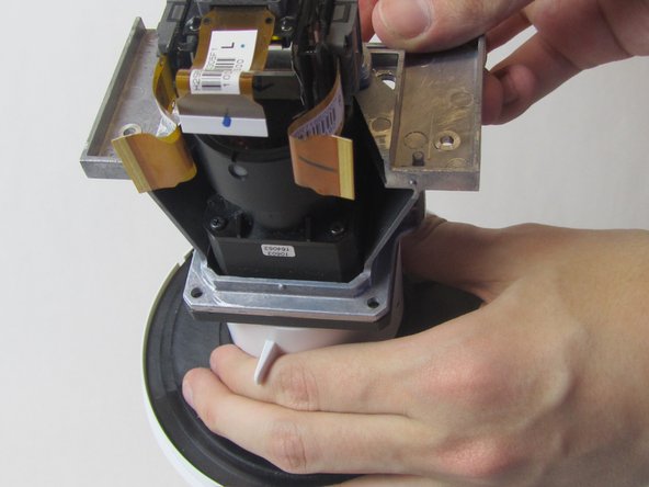

    2. Epson Powerlite 410W Lens Replacement: crwdns2935265:09crwdnd2935265:01crwdnd2935265:02crwdne2935265:0 Epson Powerlite 410W Lens Replacement: crwdns2935265:09crwdnd2935265:02crwdnd2935265:02crwdne2935265:0
      • Remove the four silver screws from the base of the lens.
    3. Epson Powerlite 410W Lens Replacement: crwdns2935265:010crwdnd2935265:01crwdnd2935265:02crwdne2935265:0 Epson Powerlite 410W Lens Replacement: crwdns2935265:010crwdnd2935265:02crwdnd2935265:02crwdne2935265:0
      • Pull the lens assembly out from the silver bracket.
