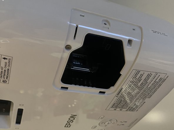

  2. Epson PowerLite Home Cinema 3020 Projector Lamp Replacement: crwdns2935265:02crwdnd2935265:01crwdnd2935265:01crwdne2935265:0
    • Use a Phillips #00 screwdriver to unscrew the captive screw on the lamp cover.
    • Slowly remove the cover once unscrewed.
