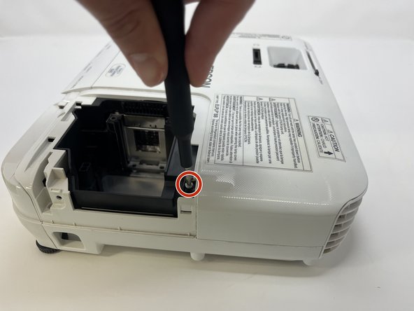

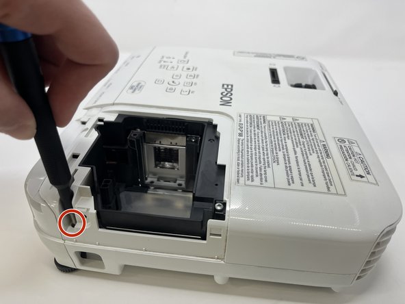

    • Use the Phillips #2 screwdriver to remove the 9 mm screw that secures the lamp cover.
    • Slide off the lamp cover and remove it from the projector.
    • If the lamp is broken, glass fragments may be found when removing the lamp cover. Be careful when removing the lamp cover and when removing the glass.

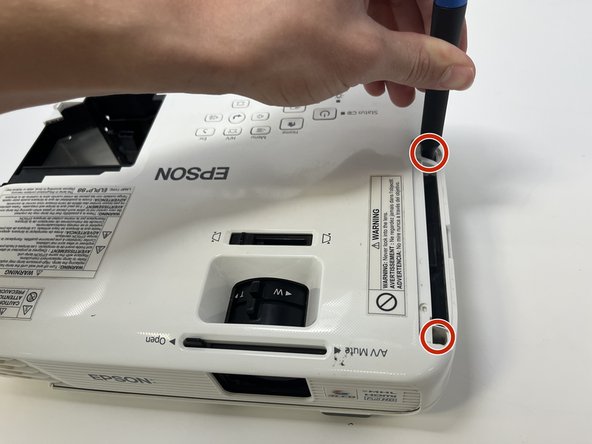

    • Remove the two black, PH1, 6mm screws.
  6. Epson PowerLite Home Cinema 1040 Temperature Sensor Replacement: crwdns2935265:06crwdnd2935265:01crwdnd2935265:03crwdne2935265:0 Epson PowerLite Home Cinema 1040 Temperature Sensor Replacement: crwdns2935265:06crwdnd2935265:02crwdnd2935265:03crwdne2935265:0 Epson PowerLite Home Cinema 1040 Temperature Sensor Replacement: crwdns2935265:06crwdnd2935265:03crwdnd2935265:03crwdne2935265:0

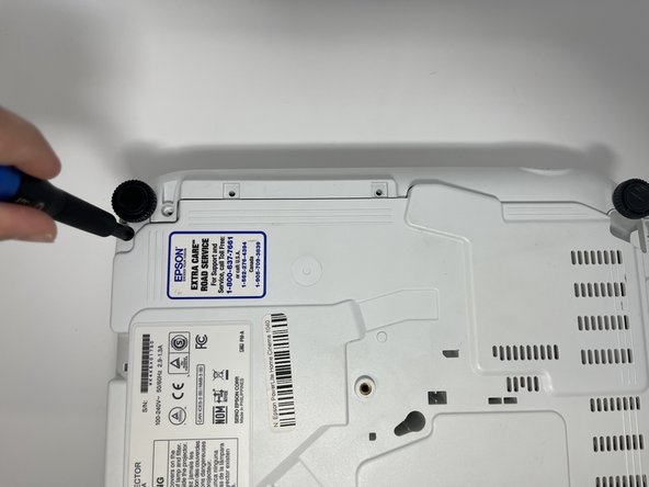

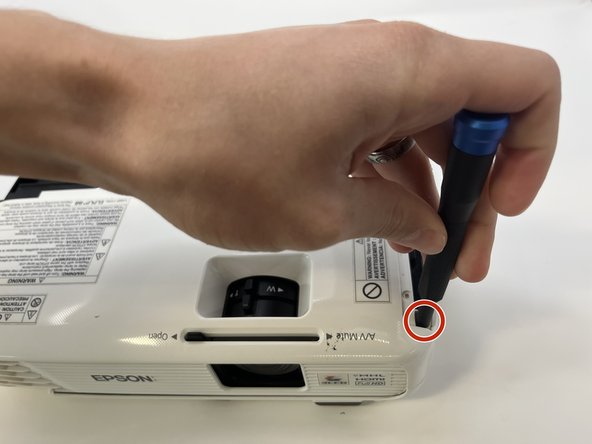

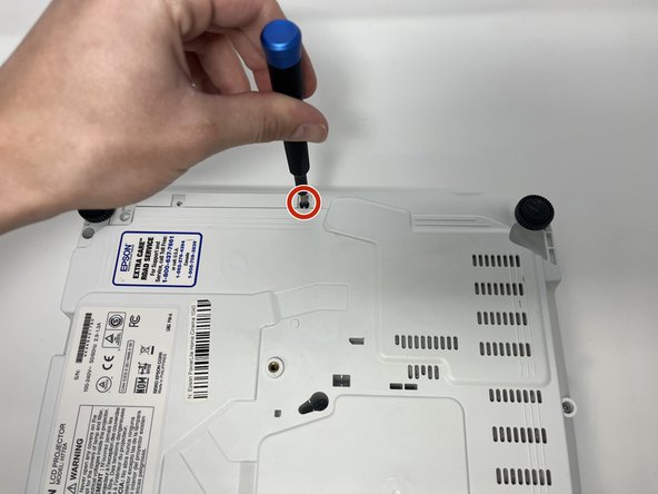

    • Flip the projector so the bottom is exposed.
    • Remove seven PH1 7mm screws on the outer rim of the projector.
    • Some screws are located deeper in the housing and a bit extension or longer screwdriver may be required.

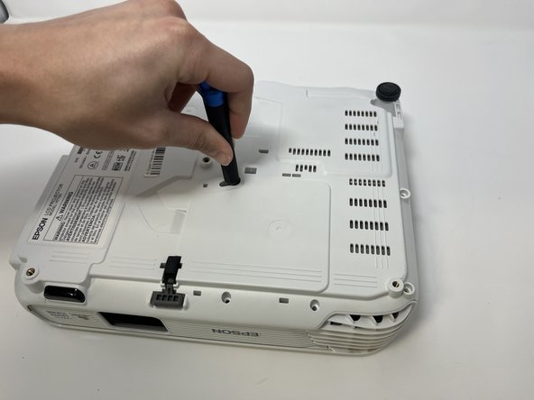

    • Continuing on the bottom, remove the two black, PH1, 6mm screws.
  8. Epson PowerLite Home Cinema 1040 Temperature Sensor Replacement: crwdns2935265:08crwdnd2935265:01crwdnd2935265:02crwdne2935265:0 Epson PowerLite Home Cinema 1040 Temperature Sensor Replacement: crwdns2935265:08crwdnd2935265:02crwdnd2935265:02crwdne2935265:0

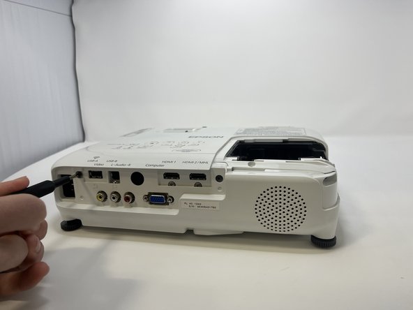

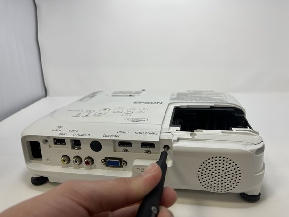

    • Remove the cover on the backside of the projector where the inputs are located.
  9. Epson PowerLite Home Cinema 1040 Temperature Sensor Replacement: crwdns2935265:09crwdnd2935265:01crwdnd2935265:03crwdne2935265:0 Epson PowerLite Home Cinema 1040 Temperature Sensor Replacement: crwdns2935265:09crwdnd2935265:02crwdnd2935265:03crwdne2935265:0 Epson PowerLite Home Cinema 1040 Temperature Sensor Replacement: crwdns2935265:09crwdnd2935265:03crwdnd2935265:03crwdne2935265:0

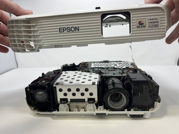

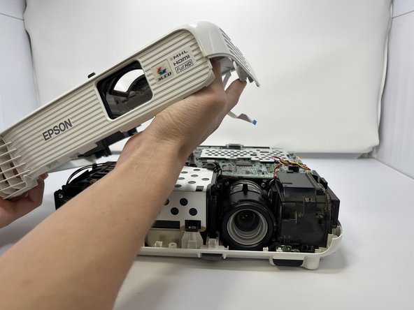

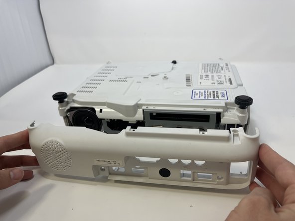

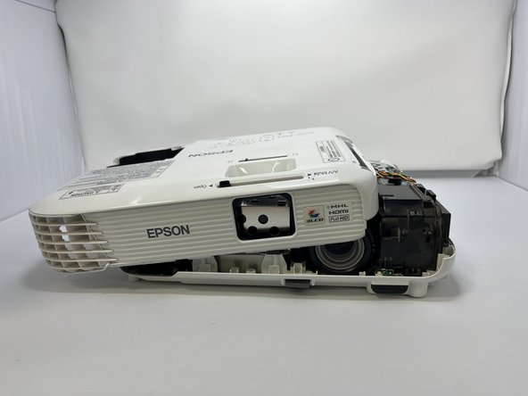

    • Pull the top half of the housing upwards and rest it on the side.
    • Be careful to not pull upwards too hard. The top is still connected by a thin electric strip.

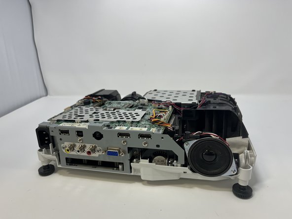

  10. Epson PowerLite Home Cinema 1040 Temperature Sensor Replacement: crwdns2935265:010crwdnd2935265:01crwdnd2935265:03crwdne2935265:0 Epson PowerLite Home Cinema 1040 Temperature Sensor Replacement: crwdns2935265:010crwdnd2935265:02crwdnd2935265:03crwdne2935265:0 Epson PowerLite Home Cinema 1040 Temperature Sensor Replacement: crwdns2935265:010crwdnd2935265:03crwdnd2935265:03crwdne2935265:0
    • Using your fingernail or another thin wedging tool, disconnect the electronic strip from the motherboard.
    • Remove the top half of the projector housing completely and set it to the side.

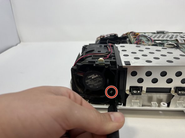

  11. Epson PowerLite Home Cinema 1040 Temperature Sensor Replacement, Temperature Sensor: crwdns2935265:011crwdnd2935265:01crwdnd2935265:03crwdne2935265:0 Epson PowerLite Home Cinema 1040 Temperature Sensor Replacement, Temperature Sensor: crwdns2935265:011crwdnd2935265:02crwdnd2935265:03crwdne2935265:0 Epson PowerLite Home Cinema 1040 Temperature Sensor Replacement, Temperature Sensor: crwdns2935265:011crwdnd2935265:03crwdnd2935265:03crwdne2935265:0

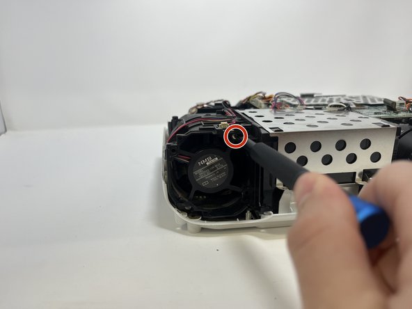

    • Use the Philips #1 to unscrew the 3 silver 7mm screws securing the fan frame in place.
  12. Epson PowerLite Home Cinema 1040 Temperature Sensor Replacement: crwdns2935265:012crwdnd2935265:01crwdnd2935265:02crwdne2935265:0 Epson PowerLite Home Cinema 1040 Temperature Sensor Replacement: crwdns2935265:012crwdnd2935265:02crwdnd2935265:02crwdne2935265:0
    • Remove the fan frame.

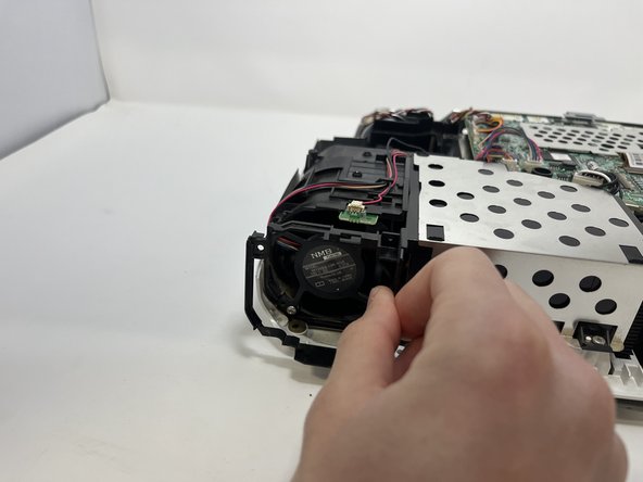

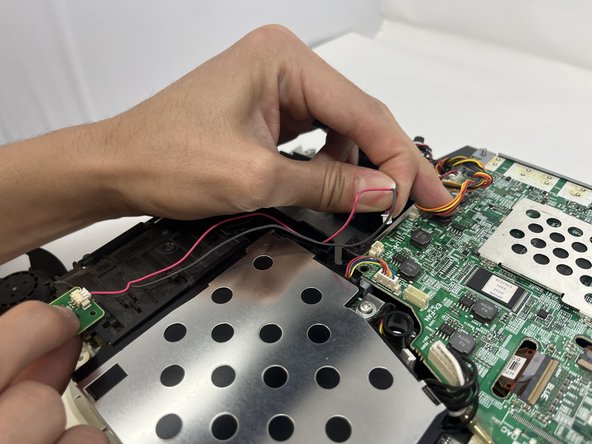

    • Locate the temperature sensor above the cooling fan.
    • Pull the green temperature sensor chip out of the plastic housing that keeps it in place.
  14. Epson PowerLite Home Cinema 1040 Temperature Sensor Replacement: crwdns2935265:014crwdnd2935265:01crwdnd2935265:02crwdne2935265:0 Epson PowerLite Home Cinema 1040 Temperature Sensor Replacement: crwdns2935265:014crwdnd2935265:02crwdnd2935265:02crwdne2935265:0
    • Unhook the red and black temperature sensor wires that lead to the motherboard.
    • Remove the temperature sensor from the projector.
    • These wires are small and removing them can be difficult.
