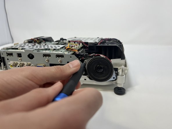

  11. Epson PowerLite Home Cinema 1040 Speaker Replacement, Speaker: crwdns2935265:011crwdnd2935265:01crwdnd2935265:02crwdne2935265:0 Epson PowerLite Home Cinema 1040 Speaker Replacement, Speaker: crwdns2935265:011crwdnd2935265:02crwdnd2935265:02crwdne2935265:0
    • Remove the two PH1 7mm silver screws that secure the speaker.

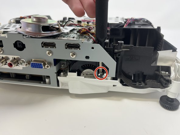

  12. Epson PowerLite Home Cinema 1040 Speaker Replacement: crwdns2935265:012crwdnd2935265:01crwdnd2935265:02crwdne2935265:0 Epson PowerLite Home Cinema 1040 Speaker Replacement: crwdns2935265:012crwdnd2935265:02crwdnd2935265:02crwdne2935265:0
    • Remove the two PH1 7mm silver screws that secure the speaker frame.
    • This helps free the speaker wires.

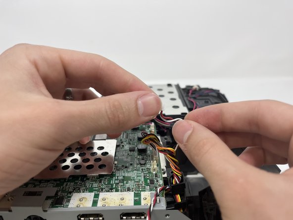

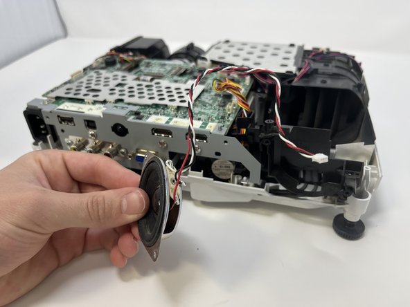

  13. Epson PowerLite Home Cinema 1040 Speaker Replacement: crwdns2935265:013crwdnd2935265:01crwdnd2935265:03crwdne2935265:0 Epson PowerLite Home Cinema 1040 Speaker Replacement: crwdns2935265:013crwdnd2935265:02crwdnd2935265:03crwdne2935265:0 Epson PowerLite Home Cinema 1040 Speaker Replacement: crwdns2935265:013crwdnd2935265:03crwdnd2935265:03crwdne2935265:0
    • Unhook the red, white and black speaker wires that connect to the motherboard.
    • Uncoil the speaker wires from the rest of the wires.
    • Remove the speaker from the projector.
