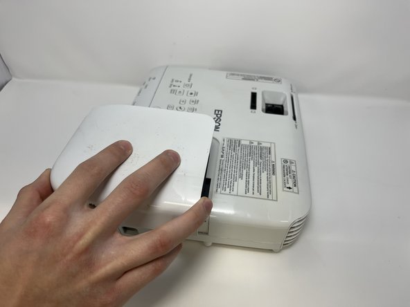

  3. Epson PowerLite Home Cinema 1040 Lamp Replacement: crwdns2935265:03crwdnd2935265:01crwdnd2935265:02crwdne2935265:0 Epson PowerLite Home Cinema 1040 Lamp Replacement: crwdns2935265:03crwdnd2935265:02crwdnd2935265:02crwdne2935265:0
    • Slide the lamp cover off by sliding out, then up.

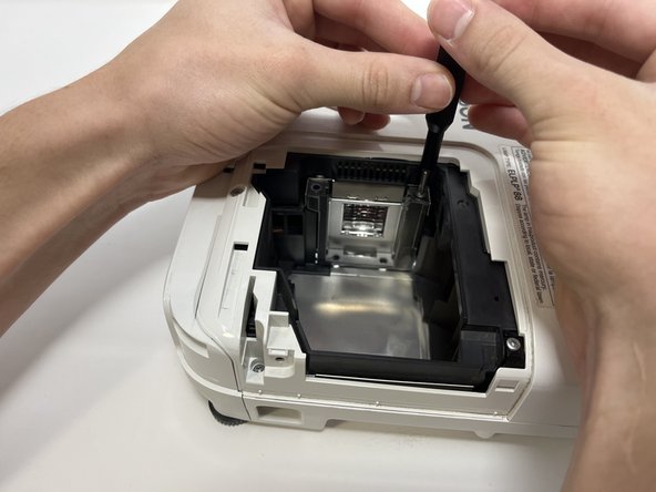

  4. Epson PowerLite Home Cinema 1040 Lamp Replacement: crwdns2935265:04crwdnd2935265:01crwdnd2935265:02crwdne2935265:0 Epson PowerLite Home Cinema 1040 Lamp Replacement: crwdns2935265:04crwdnd2935265:02crwdnd2935265:02crwdne2935265:0
    • Loosen the 7mm dark gray screws keeping the lamp in place.
    • The screws do not need to be removed. Simply loosening the screws will allow the lamp to slide out.
