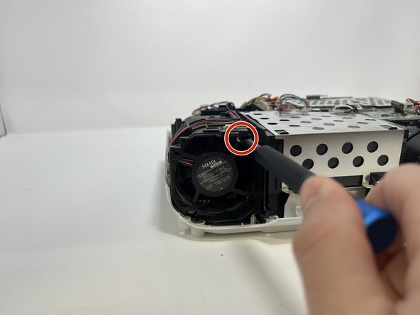

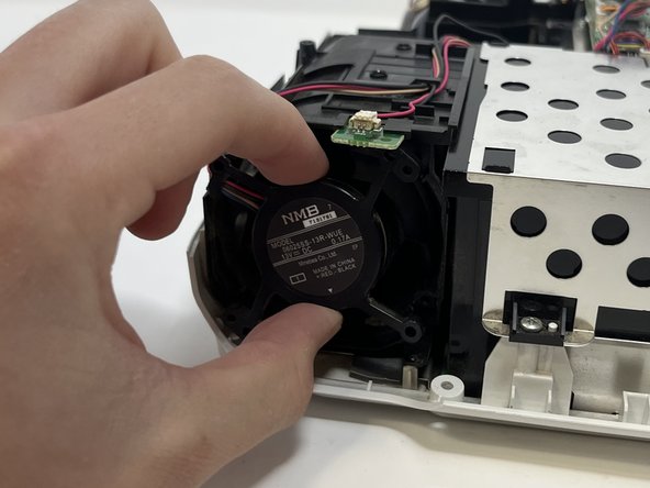

  11. Epson PowerLite Home Cinema 1040 Cooling Fan Replacement, Cooling Fan: crwdns2935265:011crwdnd2935265:01crwdnd2935265:03crwdne2935265:0 Epson PowerLite Home Cinema 1040 Cooling Fan Replacement, Cooling Fan: crwdns2935265:011crwdnd2935265:02crwdnd2935265:03crwdne2935265:0 Epson PowerLite Home Cinema 1040 Cooling Fan Replacement, Cooling Fan: crwdns2935265:011crwdnd2935265:03crwdnd2935265:03crwdne2935265:0
    • Use the Phillips #1 to remove the 3 silver 7 mm screws that secure the fan frame.

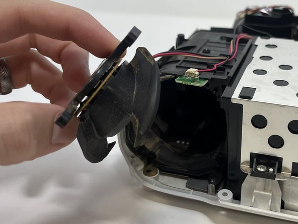

  12. Epson PowerLite Home Cinema 1040 Cooling Fan Replacement: crwdns2935265:012crwdnd2935265:01crwdnd2935265:02crwdne2935265:0 Epson PowerLite Home Cinema 1040 Cooling Fan Replacement: crwdns2935265:012crwdnd2935265:02crwdnd2935265:02crwdne2935265:0
    • Remove the fan frame.

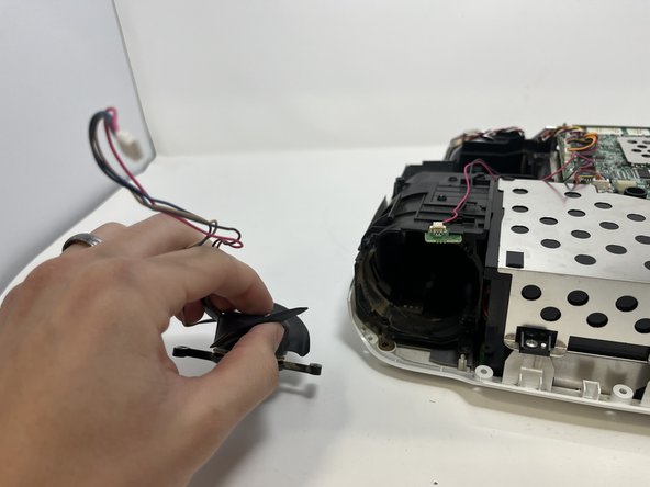

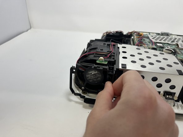

  13. Epson PowerLite Home Cinema 1040 Cooling Fan Replacement: crwdns2935265:013crwdnd2935265:01crwdnd2935265:03crwdne2935265:0 Epson PowerLite Home Cinema 1040 Cooling Fan Replacement: crwdns2935265:013crwdnd2935265:02crwdnd2935265:03crwdne2935265:0 Epson PowerLite Home Cinema 1040 Cooling Fan Replacement: crwdns2935265:013crwdnd2935265:03crwdnd2935265:03crwdne2935265:0

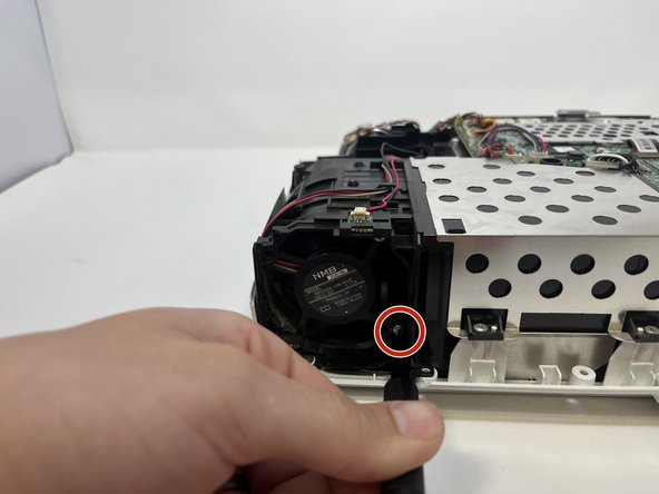

    • Use a Phillips #1 to remove the bottom left 7mm silver screw.
    • Remove the fan from inside the fan housing.
    • The fan will still be connected to the projector with the wires. We will remove those in the next step.

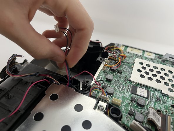

  14. Epson PowerLite Home Cinema 1040 Cooling Fan Replacement: crwdns2935265:014crwdnd2935265:01crwdnd2935265:03crwdne2935265:0 Epson PowerLite Home Cinema 1040 Cooling Fan Replacement: crwdns2935265:014crwdnd2935265:02crwdnd2935265:03crwdne2935265:0 Epson PowerLite Home Cinema 1040 Cooling Fan Replacement: crwdns2935265:014crwdnd2935265:03crwdnd2935265:03crwdne2935265:0
    • Unhook the fan wires that connect to the motherboard.
    • Separate the fan wiring from the projector.
