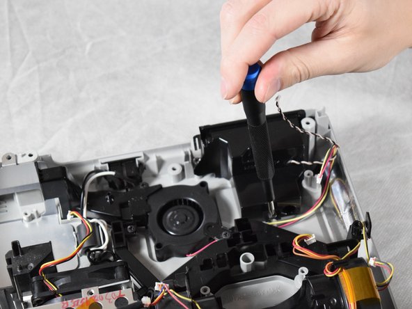

    • Remove the two 6 mm Phillips #2 screws.
    • A long, thin shank Phillips #2 screwdriver is required to remove the screws.
