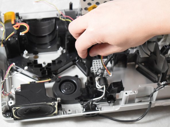

  9. Epson PowerLite 83+ Power Supply Replacement: crwdns2935265:09crwdnd2935265:01crwdnd2935265:03crwdne2935265:0 Epson PowerLite 83+ Power Supply Replacement: crwdns2935265:09crwdnd2935265:02crwdnd2935265:03crwdne2935265:0 Epson PowerLite 83+ Power Supply Replacement: crwdns2935265:09crwdnd2935265:03crwdnd2935265:03crwdne2935265:0
    • Remove the four 6 mm Phillips #2 screws securing the projector lens.
  10. Epson PowerLite 83+ Power Supply Replacement: crwdns2935265:010crwdnd2935265:01crwdnd2935265:02crwdne2935265:0 Epson PowerLite 83+ Power Supply Replacement: crwdns2935265:010crwdnd2935265:02crwdnd2935265:02crwdne2935265:0
    • Unhook the JST connector wire from wire stay and move it aside.
    • Remove the projector lens from the base.
  11. Epson PowerLite 83+ Power Supply Replacement, Power Supply: crwdns2935265:011crwdnd2935265:01crwdnd2935265:03crwdne2935265:0 Epson PowerLite 83+ Power Supply Replacement, Power Supply: crwdns2935265:011crwdnd2935265:02crwdnd2935265:03crwdne2935265:0 Epson PowerLite 83+ Power Supply Replacement, Power Supply: crwdns2935265:011crwdnd2935265:03crwdnd2935265:03crwdne2935265:0
    • Remove the sensor using a spudger and lifting it from the bottom.

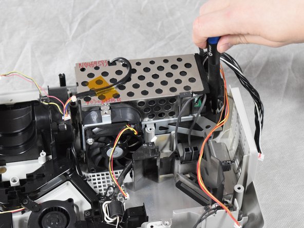

  13. Epson PowerLite 83+ Power Supply Replacement: crwdns2935265:013crwdnd2935265:01crwdnd2935265:02crwdne2935265:0 Epson PowerLite 83+ Power Supply Replacement: crwdns2935265:013crwdnd2935265:02crwdnd2935265:02crwdne2935265:0
    • Remove the three 6 mm Phillips #2 screws securing the power supply.
    • The screw located by the power supply's fan is near a magnetic field. Reinserting this screw can be difficult.
  14. Epson PowerLite 83+ Power Supply Replacement: crwdns2935265:014crwdnd2935265:01crwdnd2935265:03crwdne2935265:0 Epson PowerLite 83+ Power Supply Replacement: crwdns2935265:014crwdnd2935265:02crwdnd2935265:03crwdne2935265:0 Epson PowerLite 83+ Power Supply Replacement: crwdns2935265:014crwdnd2935265:03crwdnd2935265:03crwdne2935265:0
    • Remove the two 6 mm Phillips #2 screws securing the wire guide.
    • Remove the wires by gently lifting up the wire guide.

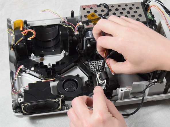

  15. Epson PowerLite 83+ Power Supply Replacement: crwdns2935265:015crwdnd2935265:01crwdnd2935265:02crwdne2935265:0 Epson PowerLite 83+ Power Supply Replacement: crwdns2935265:015crwdnd2935265:02crwdnd2935265:02crwdne2935265:0
    • Using your fingers, firmly press in the sides of the power plug while lifting up.
    • Remove the power supply.
