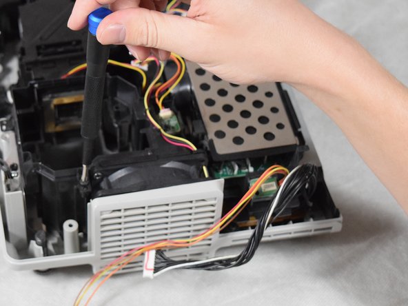

    3. Epson PowerLite 83+ Fan Replacement: crwdns2935265:010crwdnd2935265:01crwdnd2935265:03crwdne2935265:0 Epson PowerLite 83+ Fan Replacement: crwdns2935265:010crwdnd2935265:02crwdnd2935265:03crwdne2935265:0 Epson PowerLite 83+ Fan Replacement: crwdns2935265:010crwdnd2935265:03crwdnd2935265:03crwdne2935265:0
      • Remove the four 6 mm Phillips #2 screws.
      • Lift the fan bracket straight up to remove it from the casing.

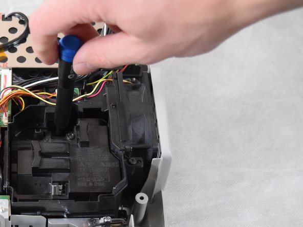

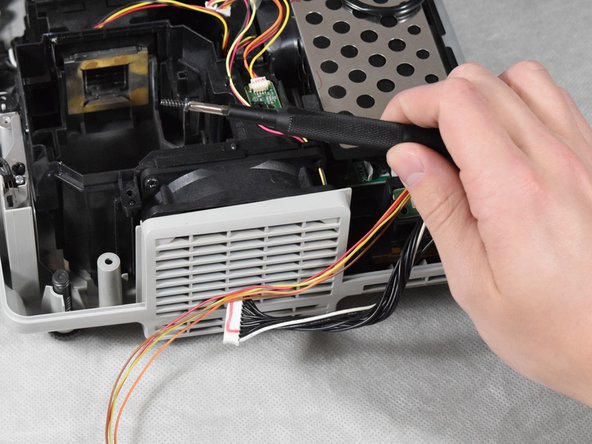

    4. Epson PowerLite 83+ Fan Replacement: crwdns2935265:011crwdnd2935265:01crwdnd2935265:02crwdne2935265:0 Epson PowerLite 83+ Fan Replacement: crwdns2935265:011crwdnd2935265:02crwdnd2935265:02crwdne2935265:0
      • Remove the two 6 mm Phillips #2 screws.
      • A long, thin shank Phillips #2 screwdriver is required to remove the screws.
    5. Epson PowerLite 83+ Fan Replacement: crwdns2935265:012crwdnd2935265:01crwdnd2935265:02crwdne2935265:0 Epson PowerLite 83+ Fan Replacement: crwdns2935265:012crwdnd2935265:02crwdnd2935265:02crwdne2935265:0
      • Remove the exhaust fan from the bracket.
