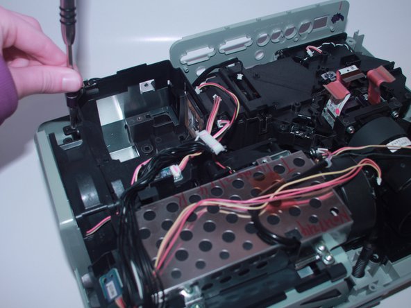

  10. Epson PowerLite 822 Plus Projector Lens Replacement, Projector Lens: crwdns2935265:010crwdnd2935265:01crwdnd2935265:03crwdne2935265:0 Epson PowerLite 822 Plus Projector Lens Replacement, Projector Lens: crwdns2935265:010crwdnd2935265:02crwdnd2935265:03crwdne2935265:0 Epson PowerLite 822 Plus Projector Lens Replacement, Projector Lens: crwdns2935265:010crwdnd2935265:03crwdnd2935265:03crwdne2935265:0
    • Use a Phillips #2 screwdriver to remove the four 6 mm screws that hold together the fan bracket.

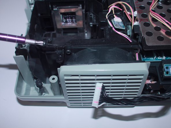

  11. Epson PowerLite 822 Plus Projector Lens Replacement: crwdns2935265:011crwdnd2935265:01crwdnd2935265:02crwdne2935265:0 Epson PowerLite 822 Plus Projector Lens Replacement: crwdns2935265:011crwdnd2935265:02crwdnd2935265:02crwdne2935265:0
    • Use a Phillips #2 screwdriver to remove the four 6 mm screws that secure the projector.
  12. Epson PowerLite 822 Plus Projector Lens Replacement: crwdns2935265:012crwdnd2935265:01crwdnd2935265:02crwdne2935265:0 Epson PowerLite 822 Plus Projector Lens Replacement: crwdns2935265:012crwdnd2935265:02crwdnd2935265:02crwdne2935265:0
    • Pull out the loose projector and it is ready to be replaced.
